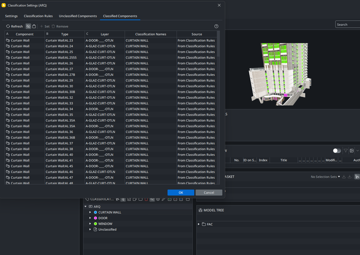

    I created a classification for Windows, Doors, and Curtain Walls.
    In the entire model, only the colors for Windows and Doors are displayed. However, if I select only Curtain Walls, their color is shown.
    The expected behavior was that the color for Curtain Walls would appear together with the colors for Windows and Doors.
    The image below shows only the colors for Windows and Doors — Curtain Walls have no color.
    But if I select in classification just curtain wall the colors appears
    Any help? @Solibrians

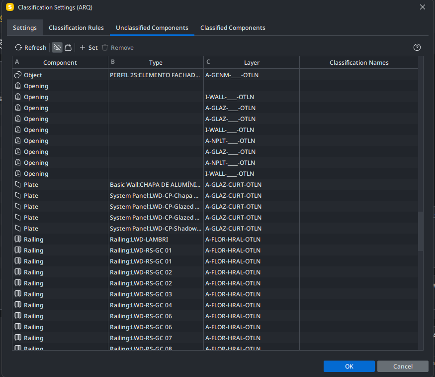

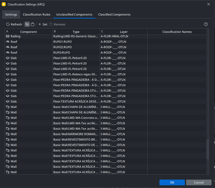

          Unclassified probably contains elements which are not classified as curtain walls but maybe have identical representations? Without the model or more information like an ITO it’s just another wild guess …

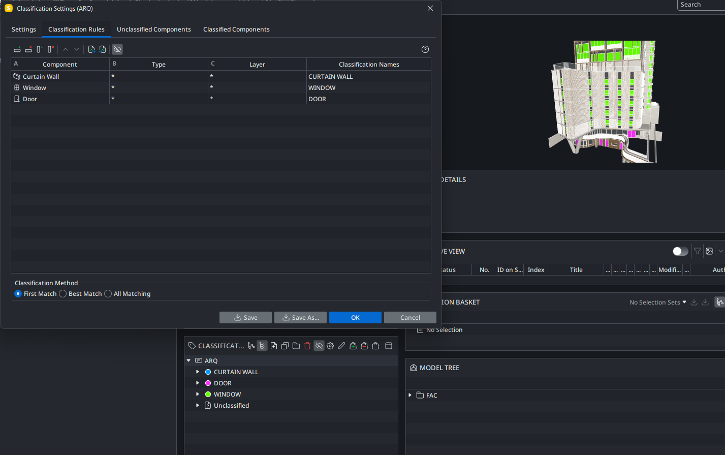

            Please try changing the classification method to ‘First Match’ and move the curtain wall to the top of the list in the Classification Rules tab.
            If that doesn’t resolve the issue, kindly share a snapshot of the Unclassified tab so we can further assess the situation.

              Hi @Rafik-Remal
              This way doesn’t works.
              Curtain wall are classified

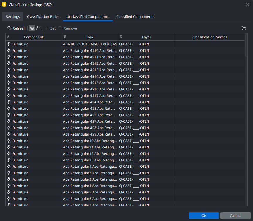

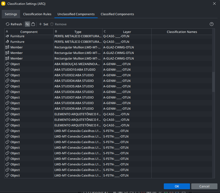

              Elements unclassified
                wrote on last edited by JSN
                Wild Guess: The curtain walls decompose into parts like Members, Doors, Panels, etc. and that’s why you are facing confusion.
                Check out the Members and Plates. E.g. exclude those which have a backward relationship with the Curtain walls or classify them as well.
