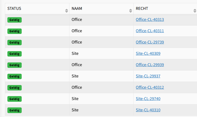

    is it possible to add a column to the Manage licenses page that shows the consuming user groups?
    it would clarify for us which of the 9 groups belong to which license

      You can see the Consuming user group(s) by clicking the Entitlement(Recht). Because there can be multiple user groups connected to one entitlement, it is not easy to visualize in one column.
