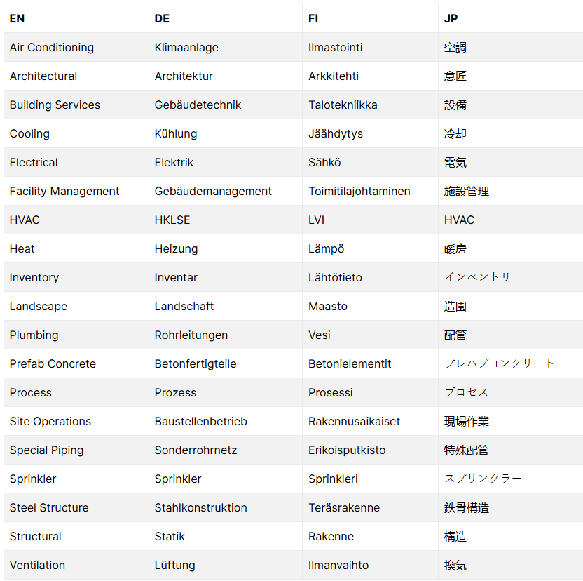

      • discipline: Specify the model discipline.
        Example: <openmodel file="C:\Users\Models\ifc\MyElModel.ifc" discipline="Electrical"/>
        Possible disciplines in different languages are:

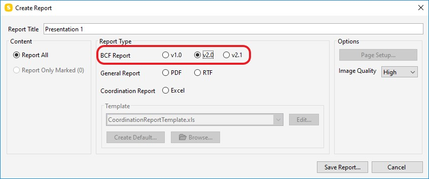

    <a id=“bcfreport”></a>
    bcfreport
    • Creates a BCF report from the Presentation view.
    • Parameters:
      • file: Specify the path and the name for the report. The file type must be .bcfzip for versions 1 & 2 and it must be .bcf for versions 2.1 and 3.0.
      • version: Specify the version of the BCF report. The version can be either 1 or 2, 2.1, 3.0.
        Examples with local file:
        <bcfreport file="C:\SolibriAutorun\reports\SolibriBuilding_BCFReport.bcfzip" version="2"/>
        <bcfreport file="C:\SolibriAutorun\reports\SolibriBuilding_BCFReport.bcf" version="2.1"/>
        <bcfreport file="C:\SolibriAutorun\reports\SolibriBuilding_BCFReport.bcf" version="3.0"/>

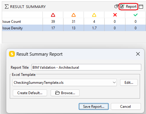

    <a id=“resultsummaryreport”></a>
    resultsummaryreport
    Since 9.13.5
    • Creates a result summary report from the Result Summary view in Excel format.
    • The file type can be .xls or .xlsx.
    • Parameters:
      • file: Specify the path and the file name for the report created by Solibri Autorun.
      • templatefile: Specify the path and the file name for the template to be used when creating the report.
      • title: Specify the title of the report (If not given the template filename is used.)
      Example with local file:
      <resultsummaryreport file="C:\SolibriAutorun\reports\Solibri Building_result_summary_report.xlsx" templatefile="C:\Users\Public\Solibri\SOLIBRI\Report Templates\Summary Report\CheckingSummaryTemplate.xlsx" title="Checking Summary"/>
      Example with remote resource: (Since: 25.6.0)
      <resultsummaryreport>
          <resource provider="Autodesk" region="EMEA" server="My Account" project="My Project" path="Project Files/Example Project/ResultSummaryReport.xlsx" role="report"/>
          <resource provider="Autodesk" region="EMEA" server="My Account" project="My Project" path="Project Files/Example Project/ResultSummaryTemplate.xlsx" role="template"/>
      </resultsummaryreport>

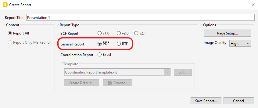

    <a id=“generalreport”></a>
    generalreport
    • Creates a report from the Presentation view in a PDF and/or RTF format.
    • Parameters:
      • pdffile: Specify the the file path and the name for the PDF report created by Solibri Autorun.
        Example: <generalreport pdffile="C:\SolibriAutorun\reports\SolibriBuilding_GeneralReport_PDF.pdf"/>
        • rtffile: Specify the the file path and the name for the RTF report created by Solibri Autorun.
          <generalreport rtffile="C:\SolibriAutorun\reports\SolibriBuilding_GeneralReport_RTF.rtf"/>
          <generalreport>`
            <resource provider="Autodesk" region="EMEA" server="My Account" project="My Project" path="Project Files/Example Project/SolibriBuilding_GeneralReport_PDF.pdf"/>`
            <resource provider="Autodesk" region="EMEA" server="My Account" project="My Project" path="Project Files/Example Project/SolibriBuilding_GeneralReport_RTF.rtf"/>`
          </generalreport>`

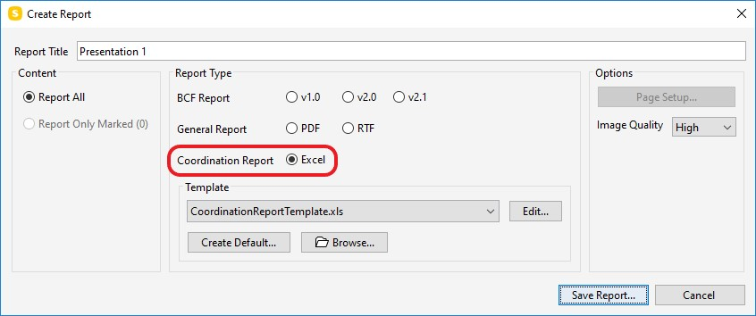

    <a id=“coordinationreport”></a>
    coordinationreport
    • Creates a coordination report from the Presentation view in Excel format.
    • Parameters:
        <coordinationreport file="C:\SolibriAutorun\reports\Solibri Building_CoordinationReport.xlsx" templatefile="C:\Users\Public\Solibri\SOLIBRI\Report Templates\Coordination Report\CoordinationReportTemplateDetailedReport.xlsx"/>
        <coordinationreport>
          <resource provider="Autodesk" region="EMEA" server="My Account" project="My Project" path="Project Files/Example Project/CoordinationReport.xlsx" role="report"/>
          <resource provider="Autodesk" region="EMEA" server="My Account" project="My Project" path="Project Files/Example Project/CoordinationReportTemplate.xlsx" role="template"/>
        </coordinationreport>
