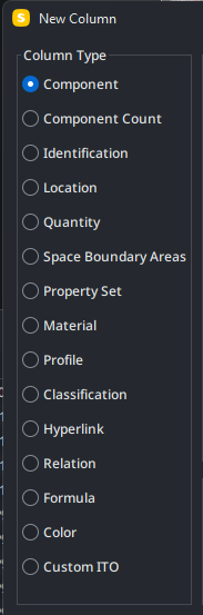

      Is JavaScript still working? I’ve been using it for years in Solibri Office and it desapeared recently from my ITO Columns menu:
      I even tryed to set “-Ddisable-javascript-running=false” but it doesn’t work. I’m using now the version 25.3.2.65.
      Regards
      Nuno

        Hi, it is there in the latest version but it was disabled for a while during the last update and licence migration phase to the Solution Center. Probably best to write them an mail as replies here are not very common …
        https://society.solibri.com/topic/3325/solibri-25-3-2-hotfix-has-been-released/11?_=1754042778432

          @Nuno said in Solibri API - Solibri JavaScript API:
          JavaScript is enabled publicly in Solibri 25.6.0: See https://society.solibri.com/topic/3367/solibri-25-6-0-has-been-released

            Thanks @Matti and @JSN !
            After installing the new version 25.6.0, Javascrit was available again.

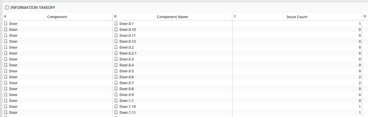

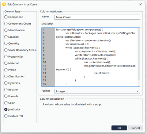

              Small example of getting issue counts for the components:
              function getValue(row, components) {
              	var allResults = Packages.com.solibri.smc.api.SMC.getChecking().getResults();
              	var cIterator = components.iterator();
              	var issueCount = 0;
              	while (cIterator.hasNext()) {
              		var component = cIterator.next();
              		var iterator = allResults.iterator();
              		while (iterator.hasNext()) {
              			var r = iterator.next();
              			if (r.getInvolvedComponents().contains(component)) {
              				issueCount++;
              	return issueCount;
              3
