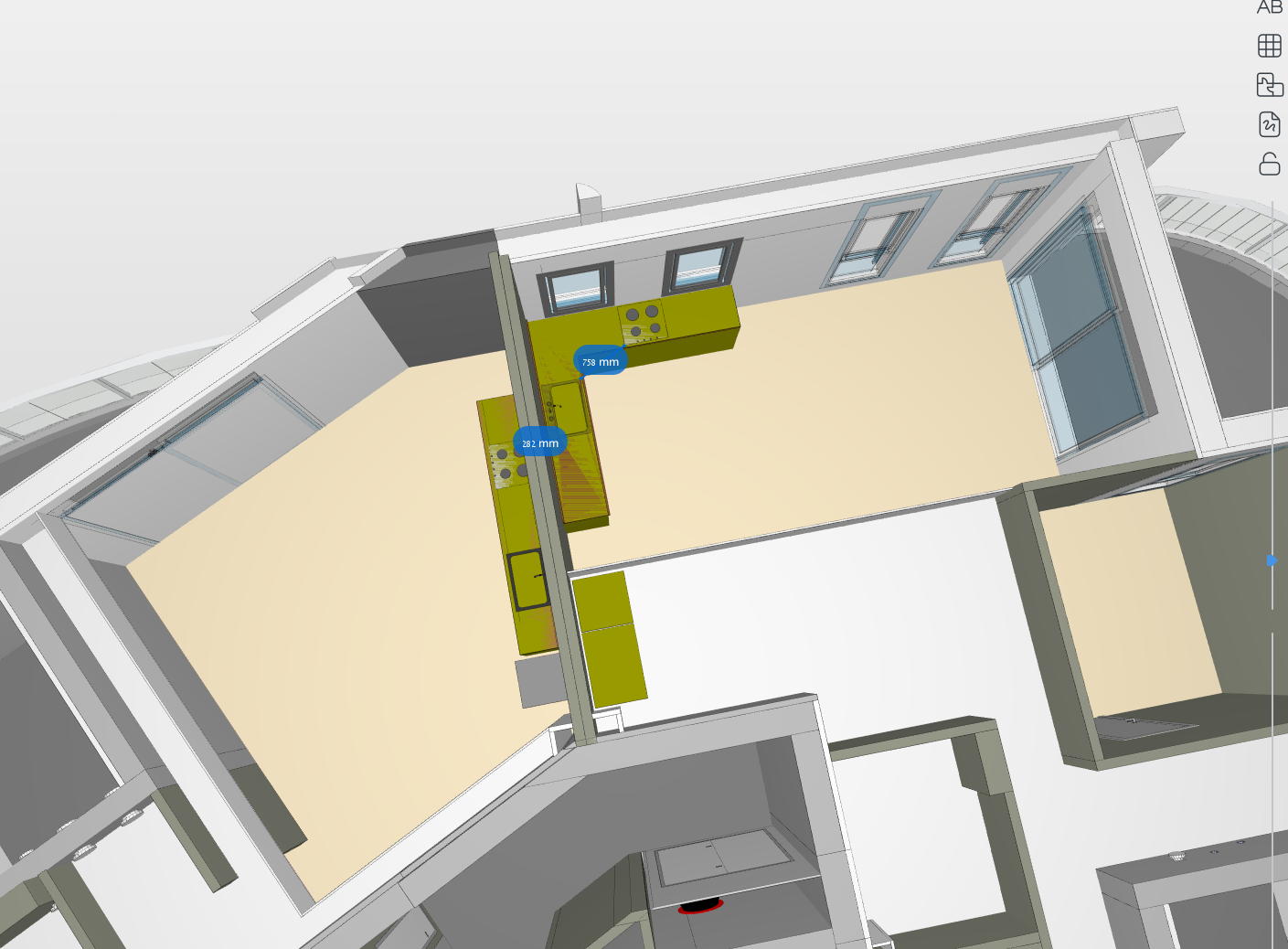

    Im using #222 in order to check distance between elements.
    The thing is that I want to check the element from the same space.
    as you can see in the picture bellow , one of the issues is between to different space (282mm)
    any idea?

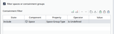

      You can limit the check to the same space by configuring the container filter in the rule 222 parameters:
        The older versions of Solibri the same configuration is:

          Thnak you @Matti
          solved!
