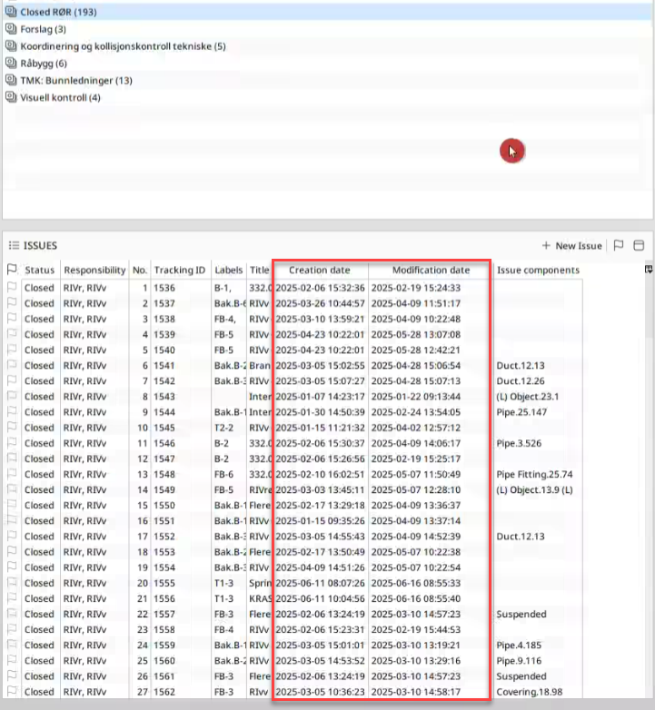

    Is there a way to extract the values shown in the image under and export them into Excel?
    I’m hoping there might be some code or method to retrieve this data, even if it’s not directly available on the webpage.

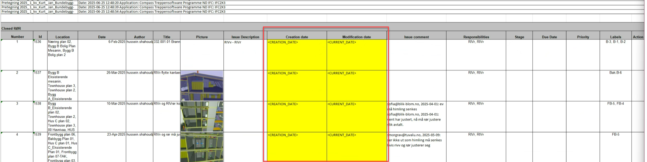

    <SLIDE_TIME> is creation date, but wonder about modification date.
    https://help.solibri.com/hc/en-us/articles/1500004671262-Creating-Reports-from-Presentations
      I think this is still valid … so probably not possible?
      https://society.solibri.com/topic/1547/excel-report-tag-list/2?_=1769425136107
