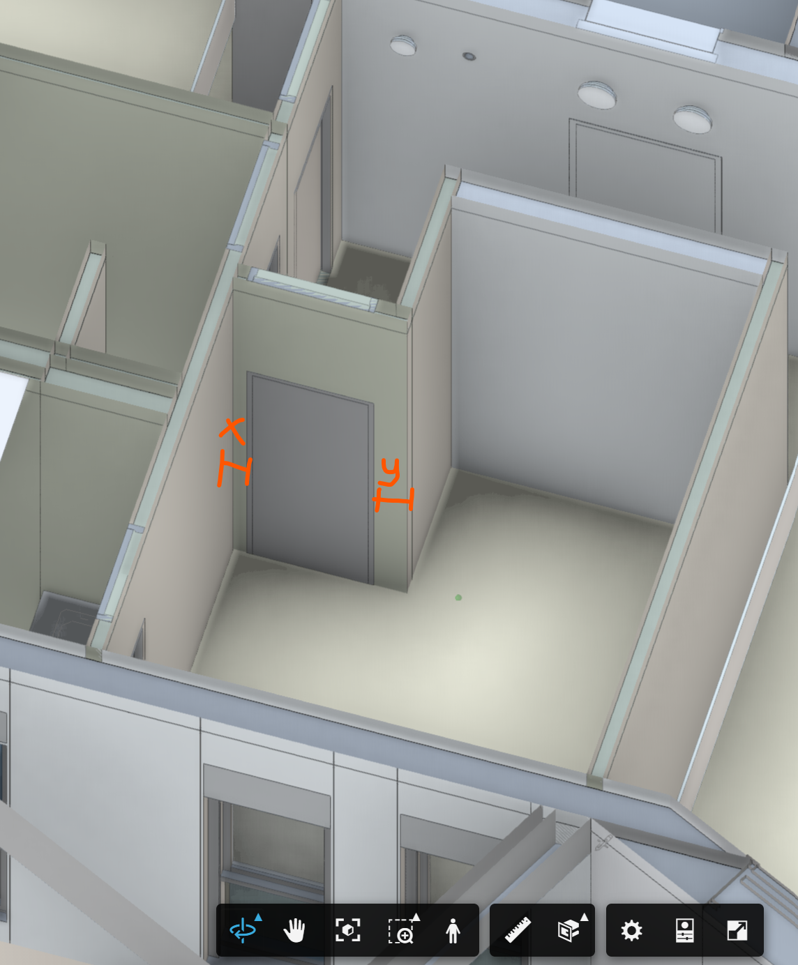

    looking for a rule to check if there is enough space (for exampl 20 cm) from left / right of a door
    in this case, X not good Y good.

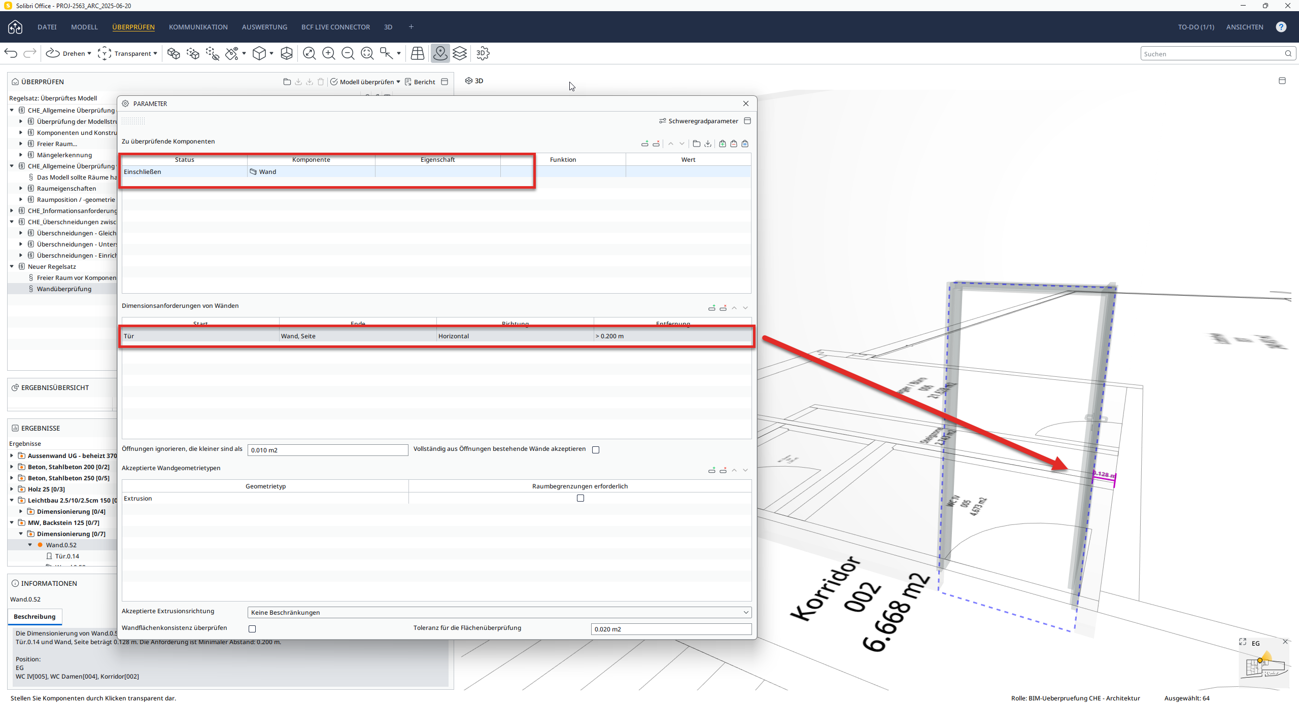

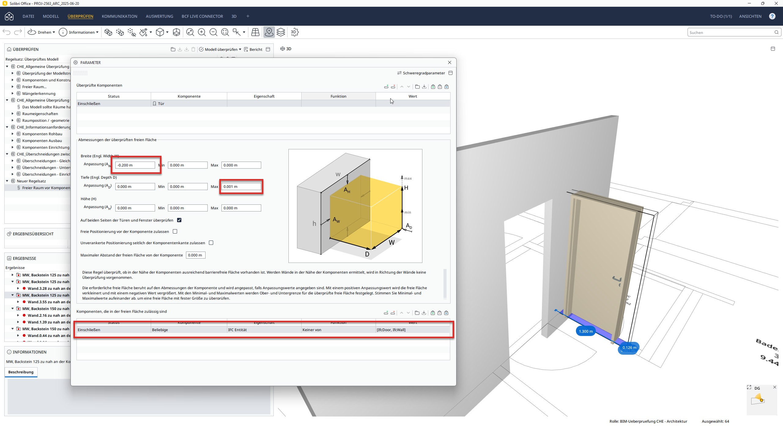

      @aroesti I wouldn’t know how to solve case Y off the top of my head. I had case X recently and was able to solve it using rule 226. Here are the rule parameters:
      Rule 216 might help in case X? Something like that?

        I found Rule 208, but its results are inconsistent, so I opened a bug report and I’m waiting for support.
