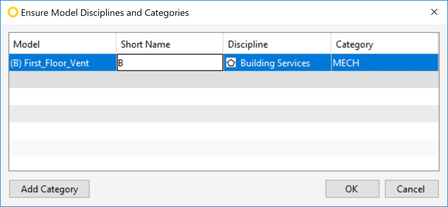

    I am talking about this:
    https://help.solibri.com/hc/en-us/articles/1500003935721-Setting-Model-Short-Name-Discipline-and-Category
    Currently loading a model is immeadiately starting and this window shows up but while the model is loading you can’t confirm your selection.
    So what’s happening right now is, that models are e.g. automatically loaded as a specific discipline by default - let’s say Architecture instead of MEP … so first we have to wait till this process is finished before we can apply the real shortname/discipline/category … which then again triggers the classification process.
    This makes no sense to me. I think there should be a setting to either completely suppress this window (e.g. when automated) or if shown then it should definitely put the loading process on hold until it’s closed!
    tl;dr: I don’t see the benefit right now in most cases as if a (big) model is loaded in the background (for a long time) you still would have to come back in the middle of the process for manual input to apply the correct values and then wait again (a long time) till the real classifications (based on category/discipline/short name) are updated.
