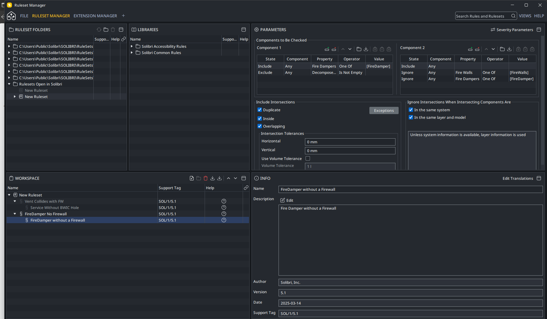

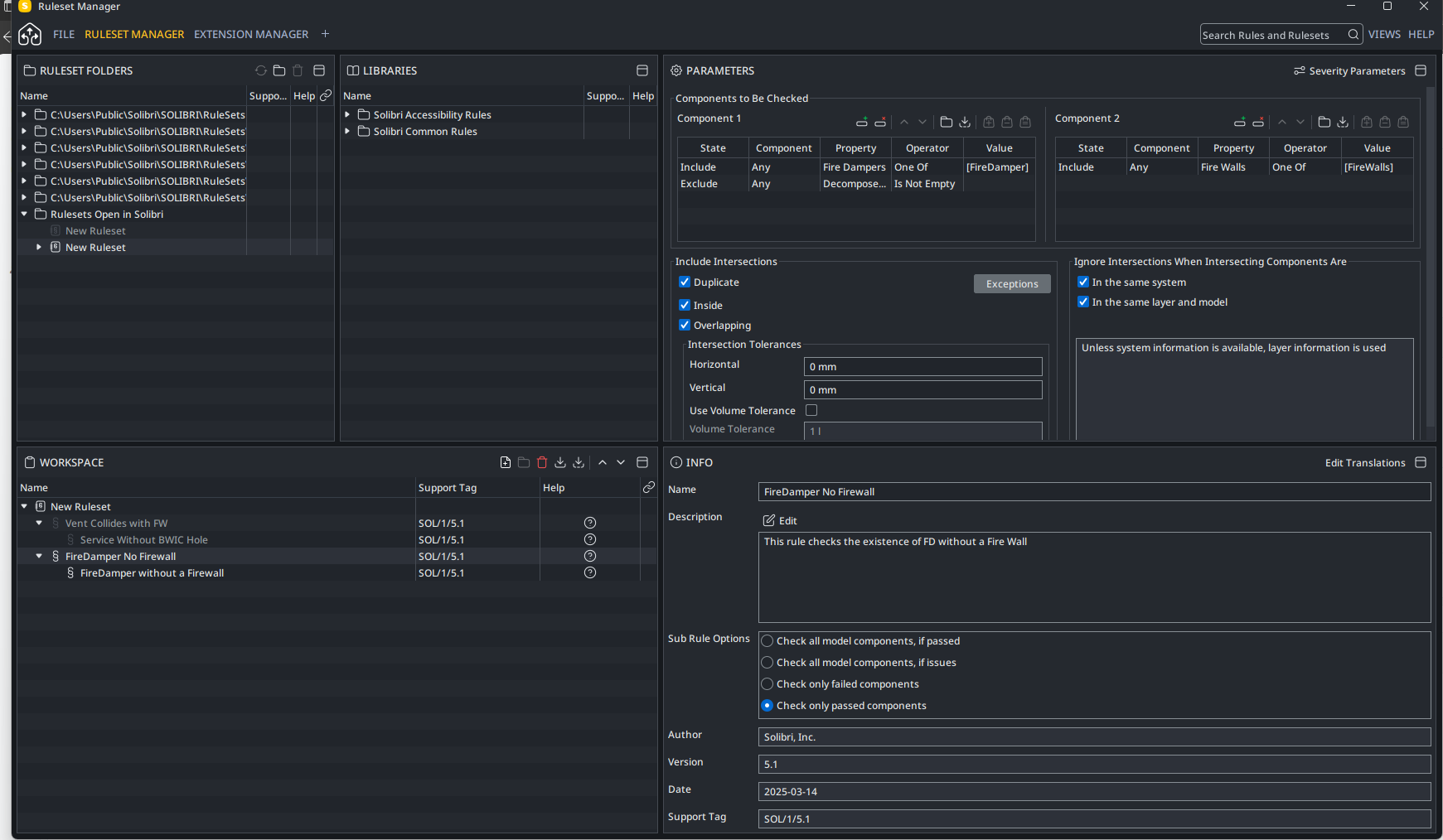

    I am trying to create a rule set to identify elements that are placed randomly into the model.
    In this case I am looking to identify Fire Dampers. I can find the elements which are located correctly i.e they are clashing with a firewall but and it does not give me the elements placed in no mans land.
    What will be good ruleset to use or can this ruleset be improved to search for elements which are placed incorrectly? Thanks

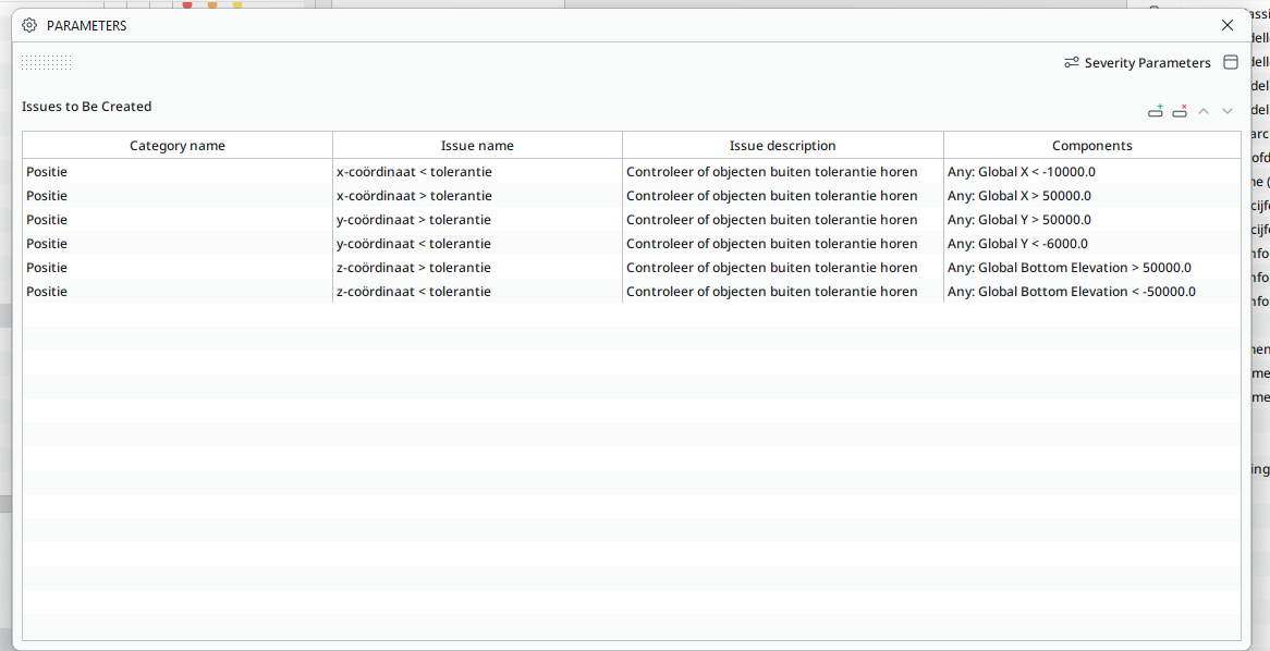

      You can use ruleset SOL/232/1.1 : Manual Checking Rule
      Create rules to create an imaginary box around your building.
      Anything outside the specified dimensions becomes an issue in this rule.
