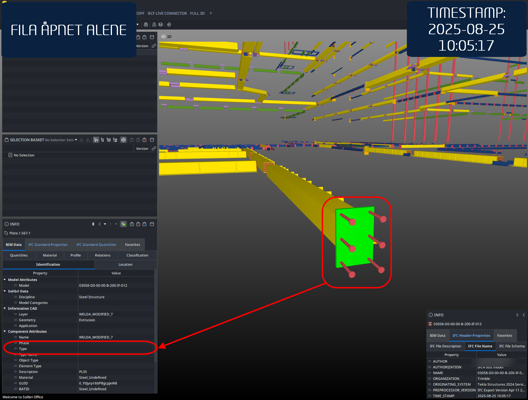

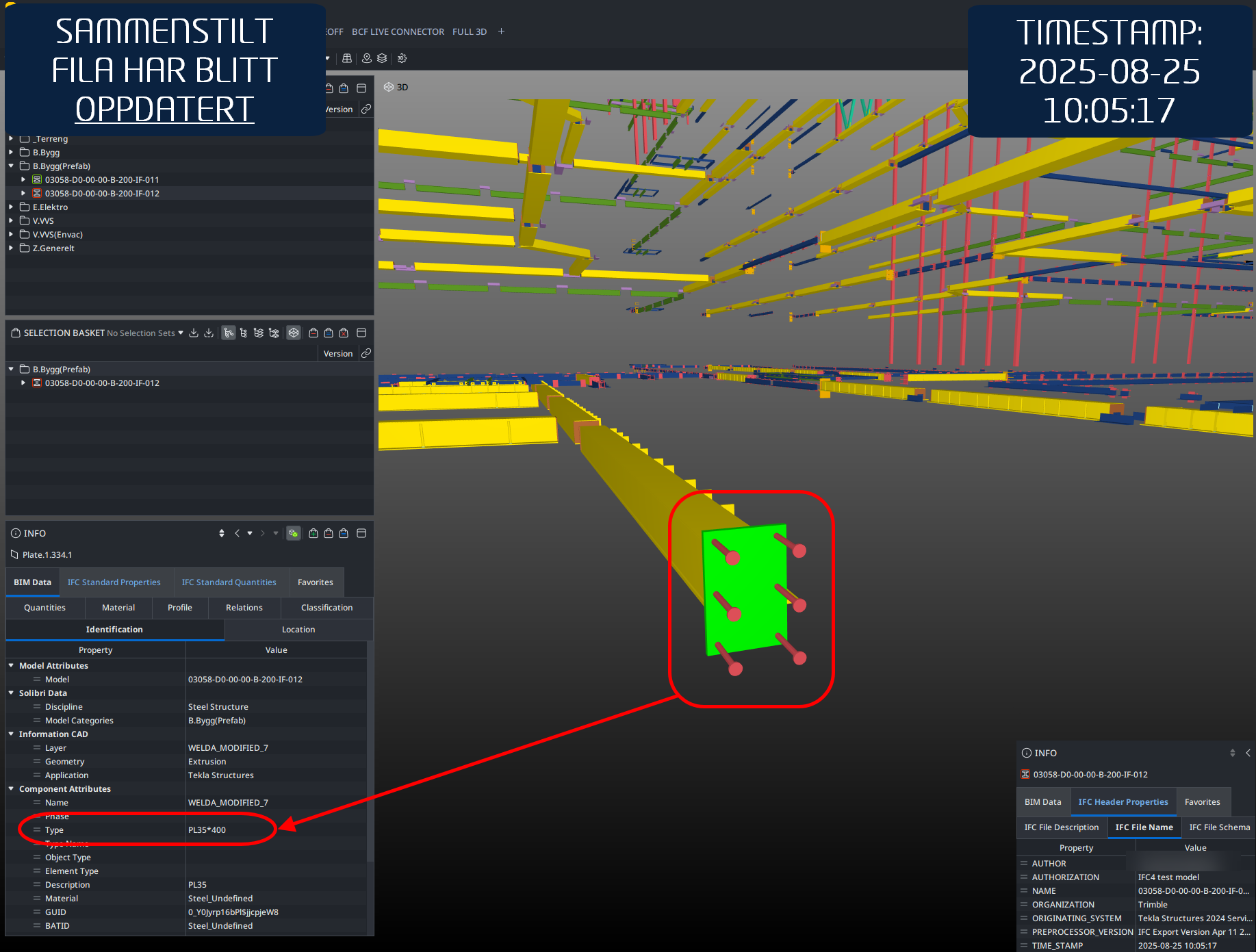

    Information can be found under “Type”:
    Information cannot be found under “Type”:
    This is exactly the same .ifc-file, the only difference is the one which contains information under “Type” is continuously being updated in a single .SMC-file (“Update model”), while the other one has been opened up separately. The “fix” for this is to remove the .ifc all together, and then re-add it, which is not really a good fix at all. We need to be able to trust that the model updates correctly every time.
