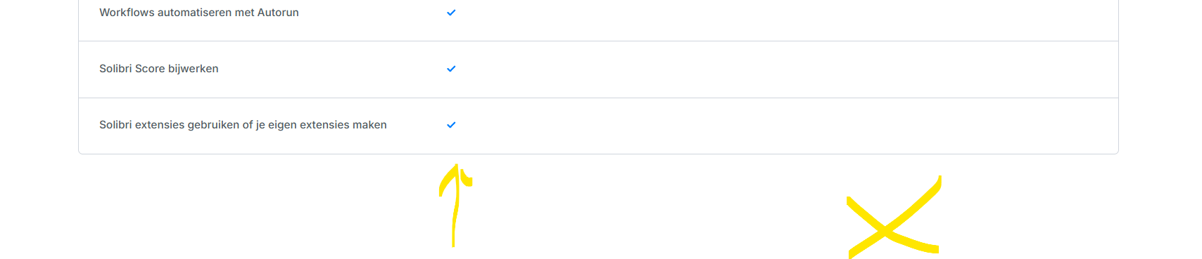

                        • Harmen JorritsmaH Offline
                          Harmen Jorritsma
                          @Mvandenbrink @tonigyllenberg
                          Is de Company Extension not only available In Solibri Office?
                          https://www.solibri.com/nl/producten
                          Met vriendelijke groet,
                          Harmen Jorritsma
                          tonigyllenbergT 1 Reply Last reply
                          • tonigyllenbergT Offline
                            tonigyllenberg Solibrians
                            replied to Harmen Jorritsma on last edited by
                            #13
                            @Harmen-Jorritsma said in Solibri center Company Extensions:
                            Generally speaking yes, this is how it has been communicated. However, the setup gets a little bit more complex when we speak about e.g. a Solibri Office license holder who is using Site.
