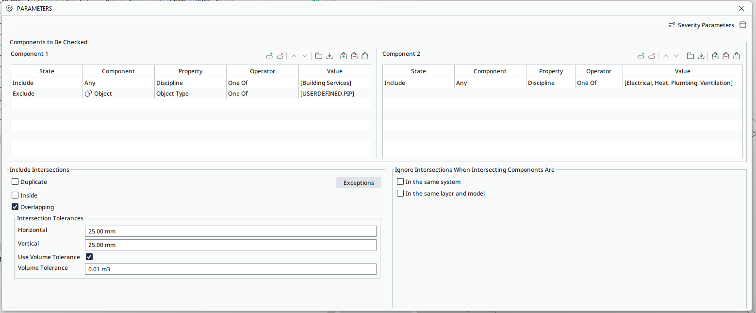

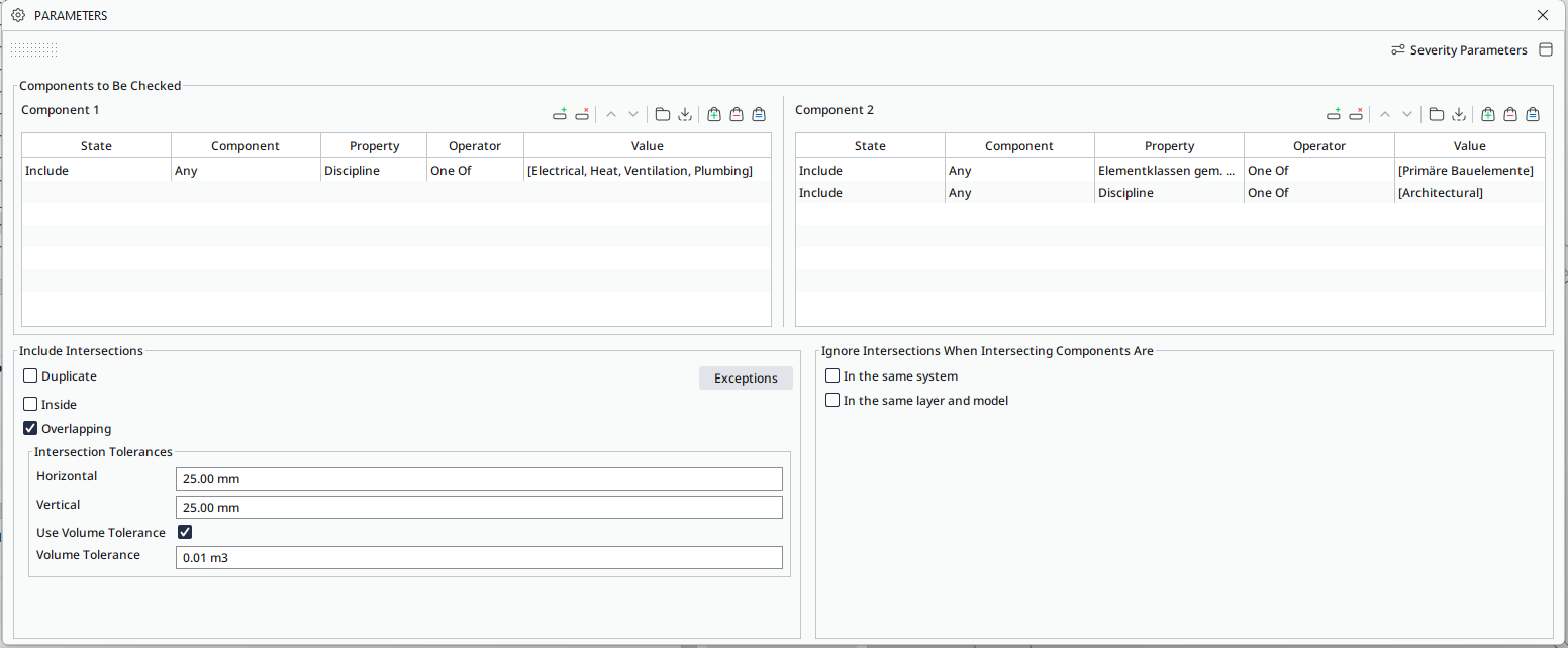

    Hi everyone! I’m very new to Solibri and struggling with PFV rules. I have a provision for void (PFV) in the model that all MEP systems should go through. I created:
    • A rule that ignores all MEP components inside the PFV.
    • A rule that flags MEP components completely outside the PFV.
    Now, I need a rule to identify MEP components that are not fully inside the PFV (i.e., partially inside or overlapping). How should I structure this rule? Additionally, I’m seeking structured learning resources for Solibri, as I find the software challenging to navigate on my own. I would greatly appreciate any recommendations for online courses, tutorials, or training programs that could help me develop my skills. Thanks a lot!

      Hi, have you heard about Gatekeeper Rules?
      • https://help.solibri.com/hc/en-us/articles/4415773412247-Using-Gatekeeper-Rules-to-Filter-Components-into-Sub-Rules
      This might also be interesting!
      • https://society.solibri.com/topic/736/provision-for-void-check-rule
        Protiimi_Johanna
        There is another discussion quite similar to your topic. I’ve alson been trying to solve this, still unsuccesful (mostly due to lack of learning time). But I suggest you take a look at this thread, maybe you’ll get some ideas:
        https://society.solibri.com/topic/2947/clash-detection-ignoring-provisionforvoid/6
