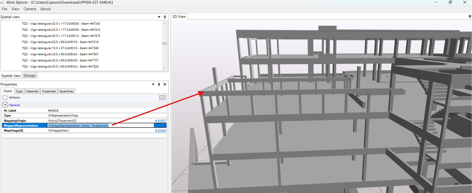

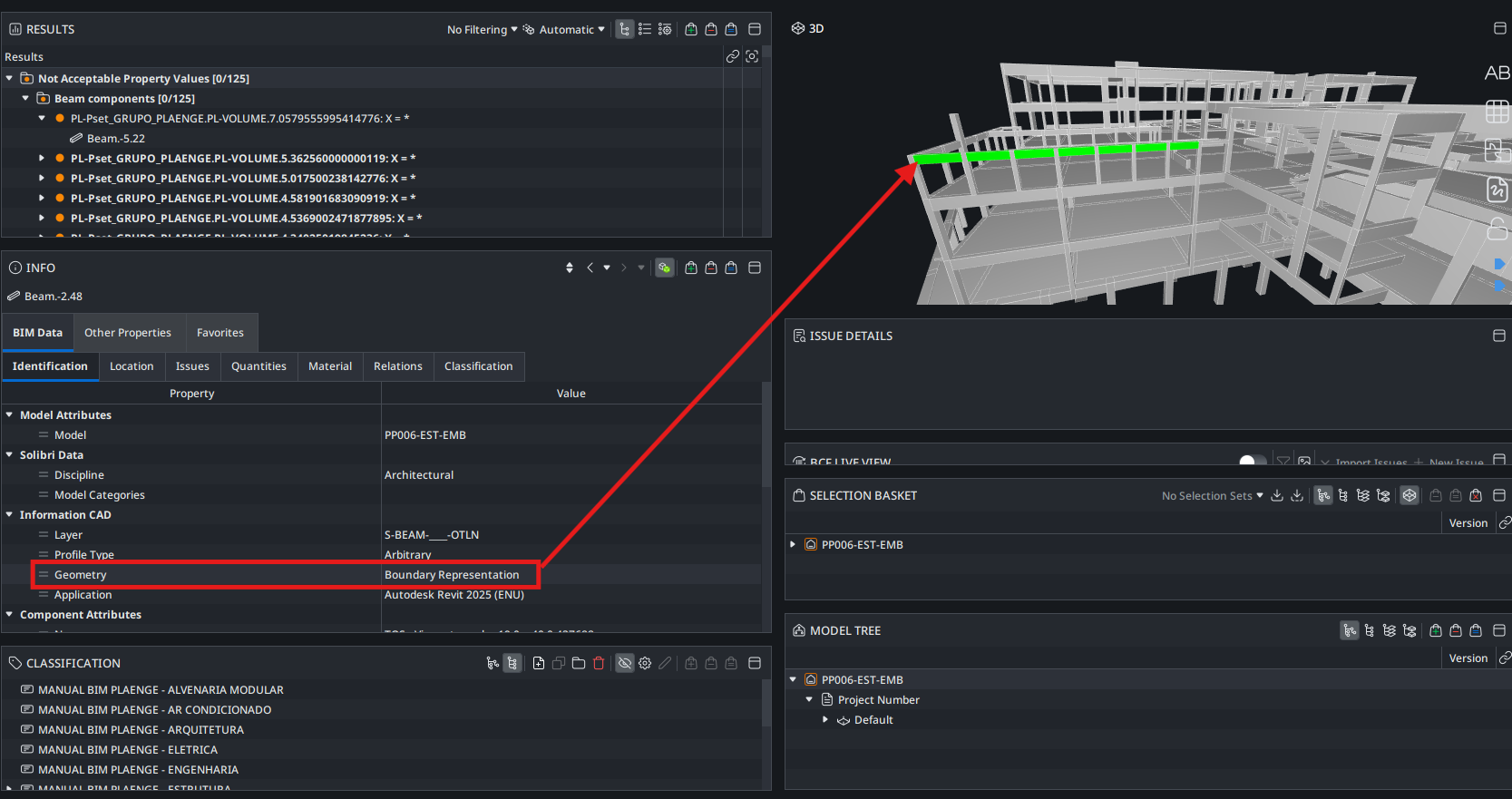

    When analyzing in X BIM, I observed that the ifcRepresentation of these beams shows some differences:
    The beams that were identified have ifcShapeRepresentation defined as (‘Body’, ‘Swept Solid’).
    The beams that were not identified have ifcShapeRepresentation defined as (‘Body’, ‘Tessellation’).

    First image – shows a beam identified by the rule, with geometry = Boundary Representation and ifcShapeRepresentation = Swept Solid.
    Second image – shows a beam not identified by the rule, also with geometry = Boundary Representation but with ifcShapeRepresentation = Tessellation.

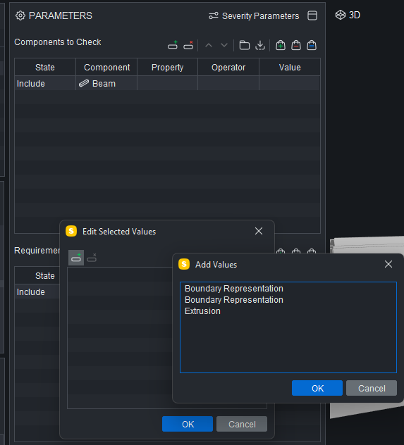

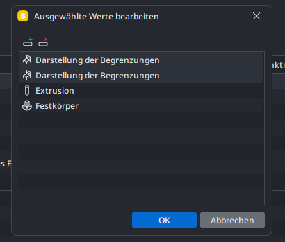

          I tested your model. The rule works, if you choose the both “Boundary Representation” values in your filter.
          There are actually two different geometry types with equal name and that causes this confusion. Just curious, what is the goal of this rule?

            I noticed that two geometries appear with the same name, but since the writings are identical, I was wondering why Solibri creates two geometries with the same name?
            The purpose of the rule is to check whether the beams are modeled continuously or modeled between columns. If the beam is modeled continuously, its geometry will be Boundary Representation. If it is modeled from column to column, then it will be of the Extrusion type.

                I use it in a different context and noticed the same. I was also wondering why there are two different types of BREPs which look like the same?
                Actually I don’t have them in all models and without reading this I would still scratch my head and wonder why I am missing stuff.
