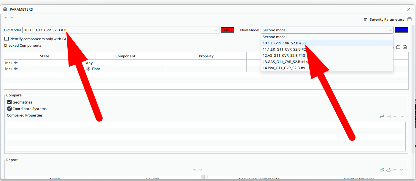

    Is it possible to chose model versions that exist in CDE rather than only in solibri? It would be great to have an option to compare before the model update in solibri.
    3
      Pasi Paasiala Solibrians
      This would require importing two versions of the same model from CDE. That feature does not yet exist, but the need is understood.
      T 1 Reply Last reply
      • T Offline
        T Offline
        twosk
        @Pasi-Paasiala Perhaps a dialog box for comparison could appear just before model update? At the moment of update there are 2 versions of the same model in solibri. Perhaps thats the fine time for comparison.
        If after comparison user could reject update, that would save so much 🙂
