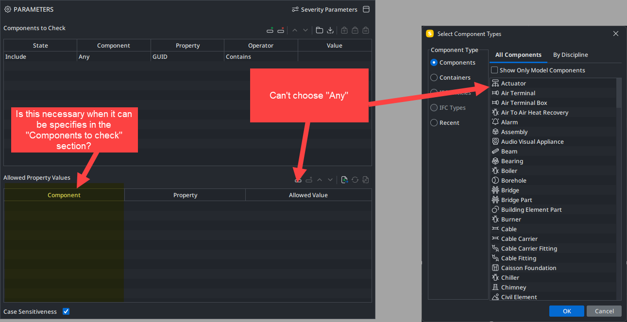

    Hi, @Solibrians
    In the rule SOL/9/3.1 (Property Values Must Be from Agreed List) it is not possible to choose “Any” when specifying the component(s) in the “Allowed Property Rules” seciton.
    Is this “Component” column necessary when you can choose which components that are being checked in the “Components to Check” section?
    It should be possible to choose “Any” in the Component column to prevent the need to add all components manually and then adding the allowed values (which often are the same) to all components.
    Is there already a way to achieve this in Solibri (25.9)?
