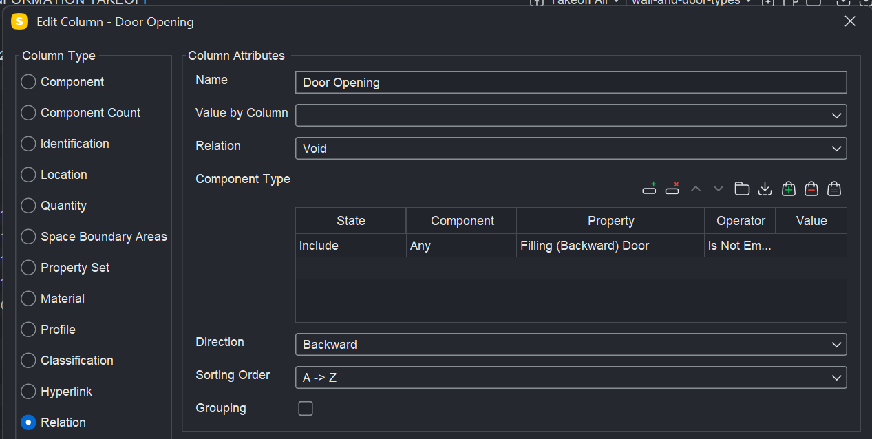

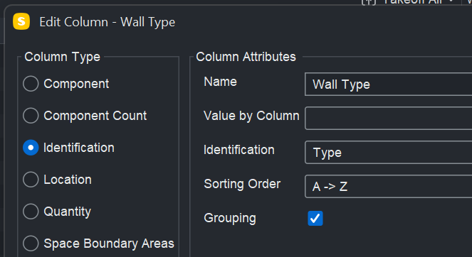

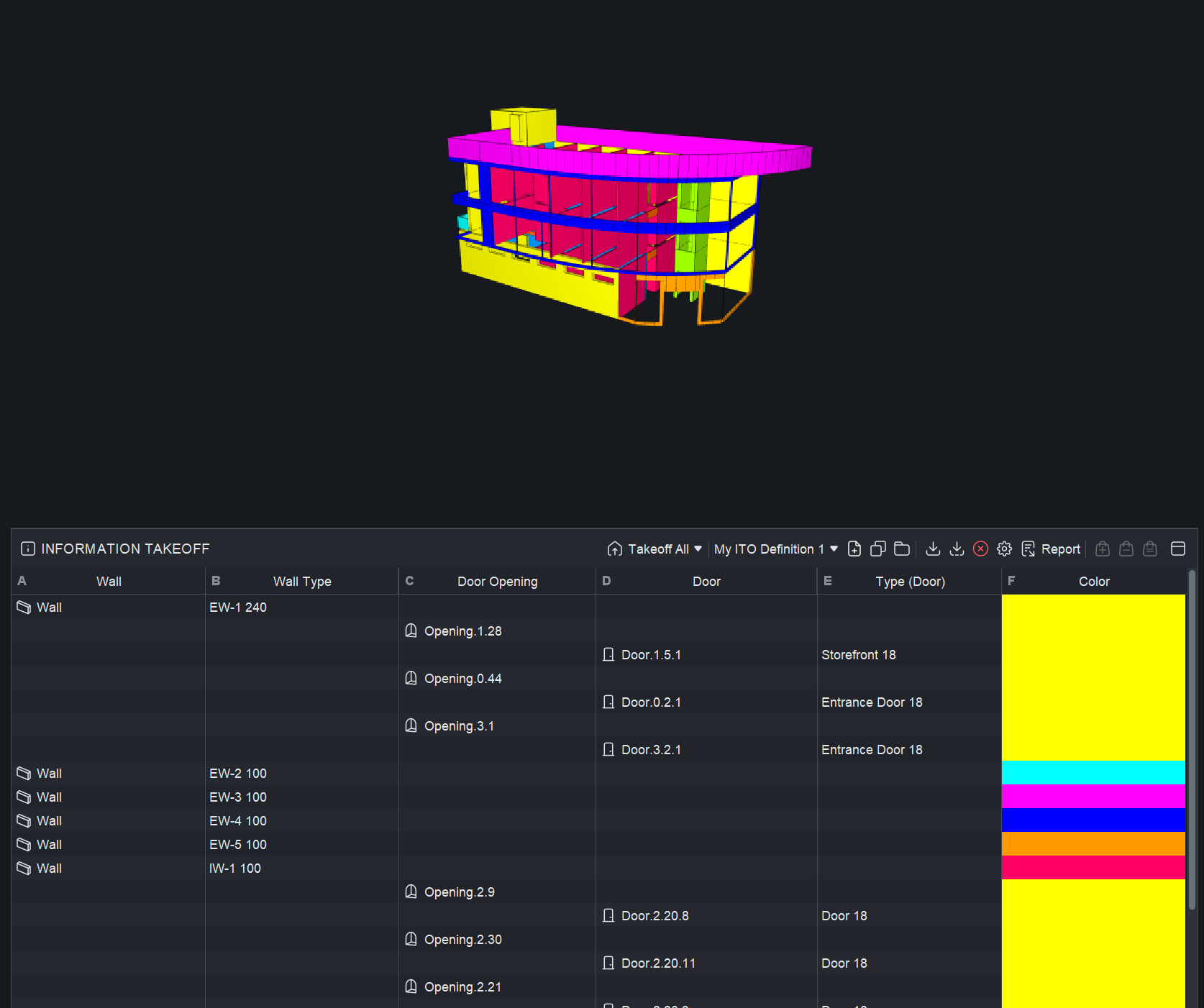

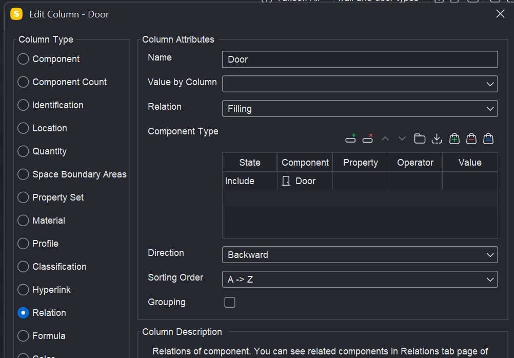

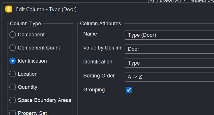

          Make new ITO listing walls with columns: wall-and-door-types.zip
          • wall type
          • wall openings filled with doors
          • doors filling the openings
          • door type

            @Matti Thanks, this works perfectly!
