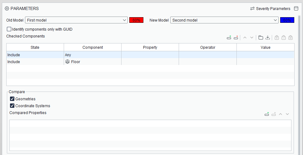

    Hello guys,
    i just did a verification on two models and i would like to know , how this rule works cause i think there is a problem
    it tells me that a lot of elements were deleted while i can still see them in the new model,
    Someone could help
    Thanks
      wrote on last edited by Matti
      Try turning ON the “Identify components only with GUIDs”.
      If your BIM tool keeps the IFC GUIDs the same, this works best.
      Otherwise the rule uses component location, geometry and few other ways to find matching components between models.
