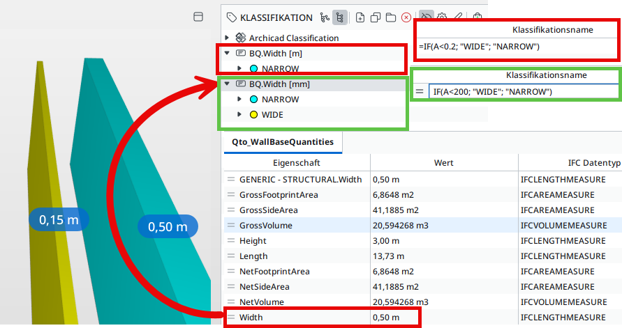

    I have encountered a Problem when trying to classify the Elements based on numerical Values - specifically, walls under 0,2m as “NARROW” and above as “WIDE”, using Qto_WallBaseQuantities.Width.
    The Formula = IF(A<0.2; “WIDE”; “NARROW”)
    the Problem is, that the numerical Value is not correctly identified when using meters, but correctly identified when using milimeters as IF(A<200; “WIDE”; “NARROW”)
    6e05df85-9a63-48af-9acd-993b87bc61c5-image.png [basequantites_width.smc]

      just saw it now:) “…Solibri internal unit of length is millimeters, regardless of user defined settings. Any calculations made use length as millimeters, and this is important to consider while creating formulas and setting formats. …”
