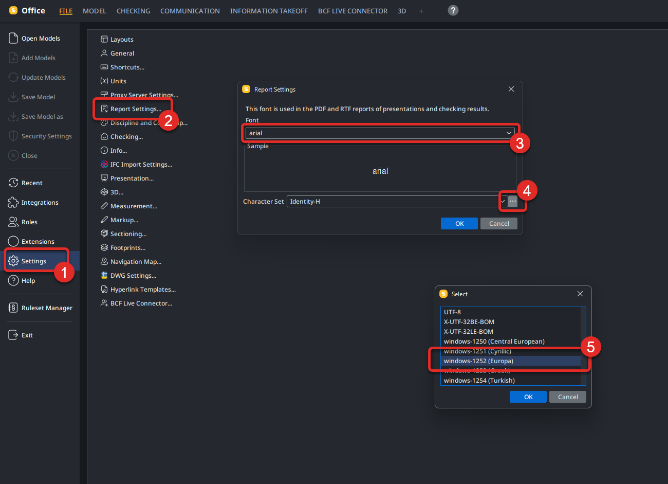

        @eh_noreger I don’t know if this is related, but we have a lot of support cases where we have to tell our customers that they need to change the character set in Solibri on macOS to Windows-1252 - after that, everything works again. I’m not sure if this setting will help with your problem, though—but it certainly can’t hurt to give it a try 😉

            @Mario Hi Mario. Thanks for the tip! I tried it but unfortunately it didn´t work on my machine. Strange thing is that after changing the character set to Windows-1252 and saving the file, it reverts back to “Identity-H”. Anyway, I´ll send .smc and log files to support and see what they figure out.
