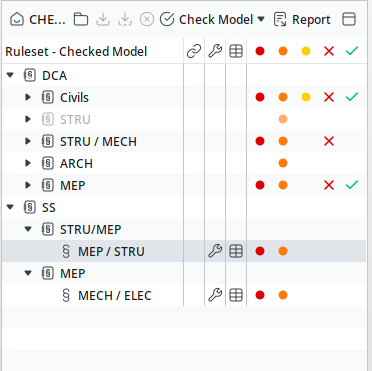

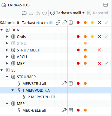

    I created a new branch in my checking rules today, but I can’t see it in Checking view.
    This is how it shows in Ruleset manager. See the first step of a gatekeeper rule under SS | STRU/MEP
    And this is my Checking view:
    I have saved and reopened this workfile.

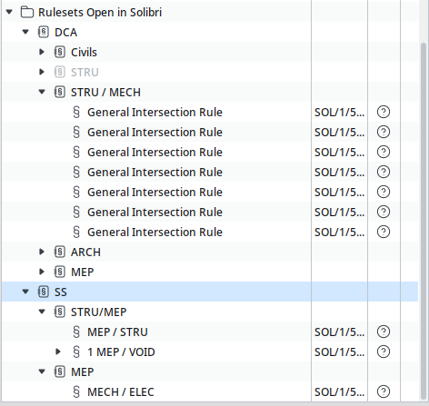

    Could this be a result from trying to change the user interface language to English (from Finnish). You can also see, that all the individually named rules are now named “General intersection rule”. Fortunately the names reappeared when I change the language back to Finnish. But the new ruleset is still missing.
    Just updated to version 26.6.0.119 yesterday.

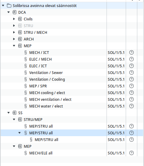

      And strange enough. The old rule names are now back in their original names (after reverting back to Finnish user interface).
      But what are all MEP/STRU all rule names? Or MECH/ELE all. I have not given those names, but they are not template names either.

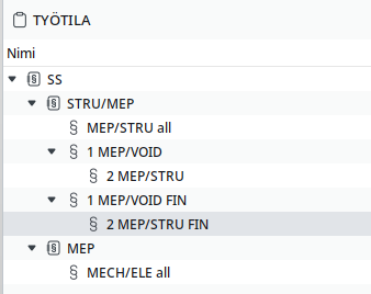

        OK. Something to do with the language change.
        I made a copy of my new cascading ruleset in Ruleset manager.
        And renamed the two new rules to have extention FIN in their names to distinguish them from the original rules that were not created in Finnish user interface.
        And now only those rules are shown in my TARKASTUS (CHECKING) view.

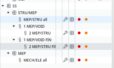

          Ah great. After running the rules also the original versions appearedNäyttökuva 2026-07-13 144832.png
          That was not the case in my first try in UK user interface.
