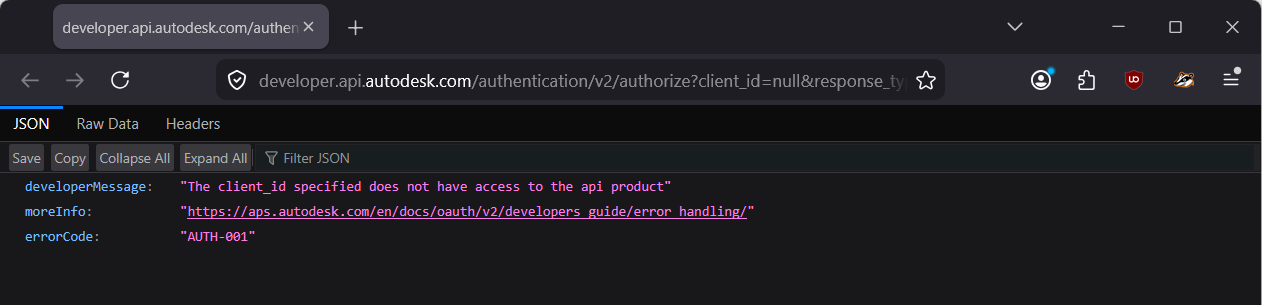

    When trying to authenticate the Autodesk Forma integration from browser, the following error message appears:
    The List of Authentication Error Codes does not show “AUTH-001”.
    Is this a Solibri-side error, or an Autodesk-side error? The Forma I am trying to connect to works just fine.
    Edit: I’ve tried installing an older Solibri version (v26.4.2) and the Forma integration seems to work again.
    Perhaps something unintended changed from 26.4.2 to 26.6.1? For now, I’ll keep running the older Solibri version.
