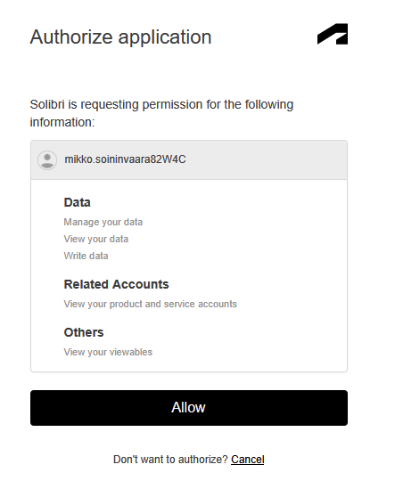

        Except that now Integration seems to be working on one project at a time?
        In the next project this page opens correctly:

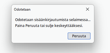

        But Solibri keeps waiting for the authentication:

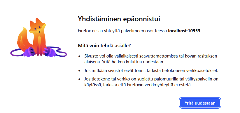

            I closed the first SMC and tried to open integration in the second one. This time browser thinks for a while and replies with an error message:
            “Firefox can not contact address Localhost:10553.”
