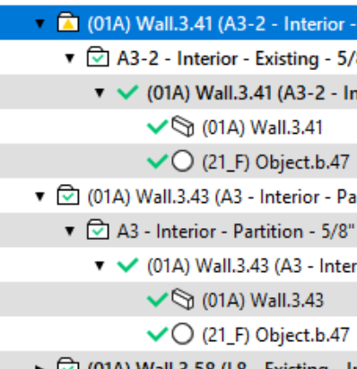

    Hi All,
    I’m a fairly new Solibri user and I’m still finding the nuances to it. One thing that is bugging me slightly is in the Checking Results list: the file icon with the red/orange/yellow triangle will automatically change to a green check mark if all the items contained are accepted, but I have a few that keep the yellow triangle anyway. This also then makes the parent icon show that there are still unresolved issues.
    Is there something I’m overlooking?

      If you have filtered the results you might end up in a situation like in the picture. Please make sure you don’t have any of the results filtered out in the results window:
      If you have this option set to “no filtering” and you still get this issue, update to the latest version and see if the problem still occurs. If so, please send a bug report to our [email protected]
