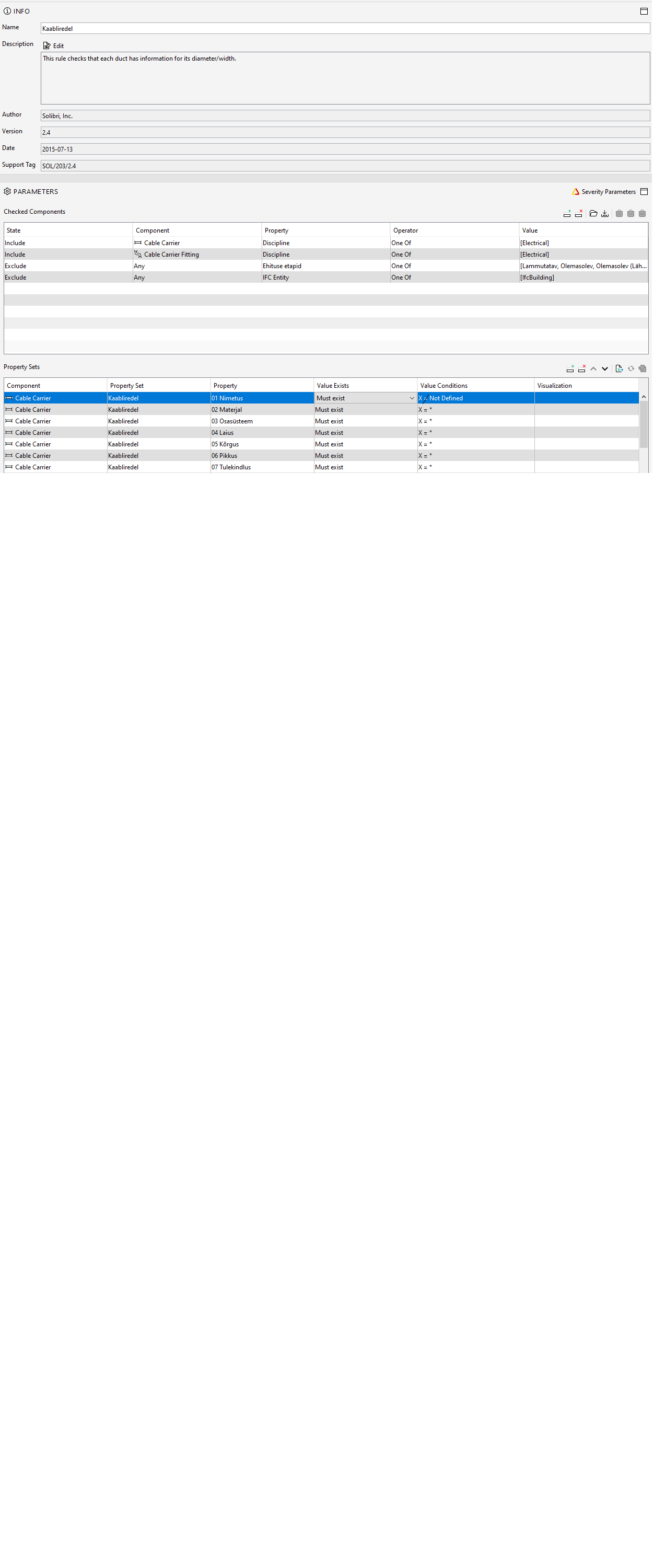

    Hello,
    Does anyone know a rule set that can create the fixed value of a property as an issue?
    I would like to see all objects per property with the value n.t.b.
    This value still needs to be filled (to be determined).
    It seems easier to me that these objects can be created in an issue, so that the components also go along with the issue.
    I can’t really find the right ruleset for this
    thanks in advance

      Hey @Harmen-Jorritsma,
      Maybe you could use just the manual checking rule 232 for this?
      In case you have a list of requirements for different elements, then try going with rules 203 or 9 which allows you to import the values by using excel.
      Also note that you can use the selection basket to easily relate components to an issue.
      1. Select components to selection basket (e.g. from ITO or classification with the “=” button)
      2. Bring selected components to issue (issue details window):
        lraimo
        I am looking solution to same problem. Is it somehow possible to add that property value not equal?
        Something like this
