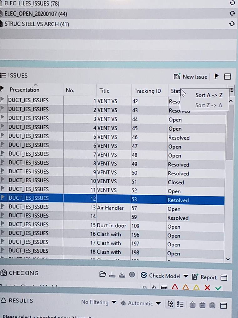

    I want to reorder my Issues list to show all the Resolved issues first. Like in Windows, I should be able to click on the ‘Status’ category and the list would reorder alphabetically A-Z, and again would do Z-A. In fact, right clicking on ‘Status’ brings up the choices ‘A-Z’ or ‘Z-A’. But nothing happens when I click this. Has anyone else experienced this, or is this a known bug? Is there a solution?

      Just drag the column to the left…
      Solibri sorts from left to right.

        @JohanE Thank you for telling me that…I don’t think I would have ever figured that out!
