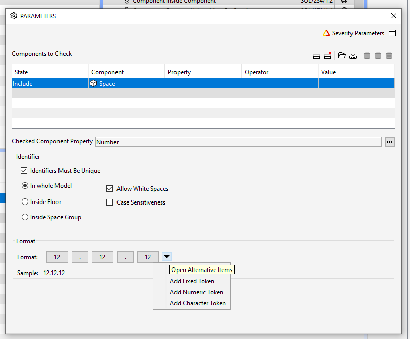

                @Simo_Z said in Allowed Property Values - Concatenated values from multiple lists:
                do you know if there is a list of "
                star (*) and question mark (?) are the only special characters used by Solibri matcher at the moment.
                • star (*) = any character zero or more times
                • question mark (?) = any character once
                You could also try rule #21 which offers custom pattern checking for ID numbers:
                • Checking for valid ID
                • Checking for uniqueness
                • Checking for consecutive numbers
                Simo_ZS 1 Reply Last reply
