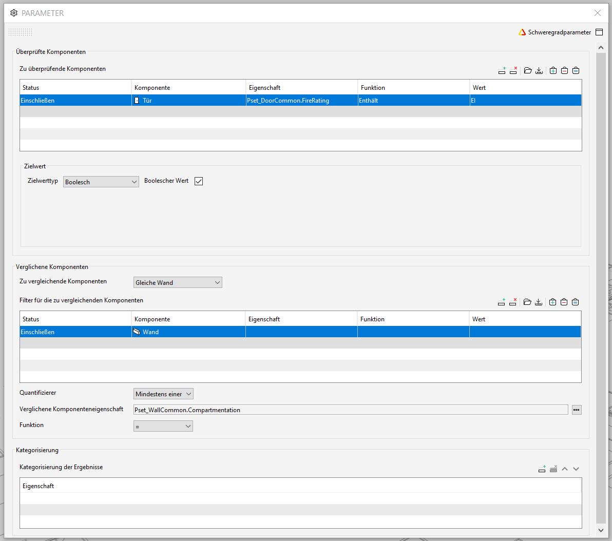

    I need a hint in creating one rule.
    I am trying to create a rule to controle if doors (firesafety EI2 30-C) are sitting correctly in Walls (as compartmentation=True).
    The door has a Pset_DoorCommon.FireSafety defined as a text, whereas the Wall has a Pset_WallCommon.Comparmentation defined as a boolean.
    I have tried it with SOL/230/1.1 and SOL/231/1.5. Also which cascading!
    Something is not going well here. Anyone could help here?

      @agroni I think this should be possible with the Rule #231:
      1. Components to check filter: set the door with the fire safety code.
      2. Components to compare: “Same wall” and in filter: walls
      3. Compared Component property: choose the “Pset_WallCommon.Comparmentation”
      4. Target Value Type: true
      Hope this works!
      if not, please upload a sample model and we can test this, thanks!

        @Lauri-Luoma
        Thanx mate…works perfect 👍
        I think the mistake that I was doing, was defining the Wall as a FireRating.Compartmenattion=True in the “Compared component property”.
        Anyway, works as a charm. So here is the recepie if someone is interested in:
