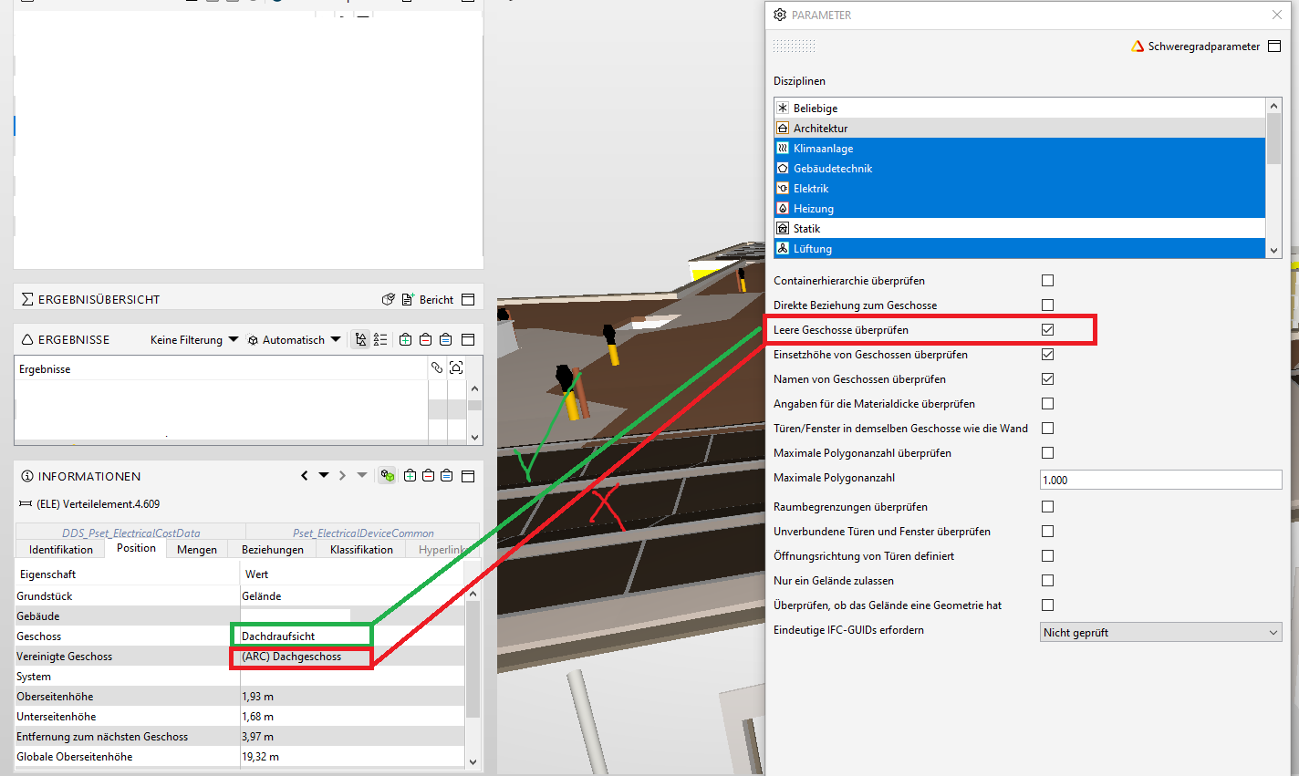

    There is a slight error in my opinion to dhe asignemt of components by Solibri. That is why I am getting an error that components do not exist in a certain storey:
    The selected component is actually in floor “Dachdraufsicht”, which also is correct in the IFC Structure. But for some reason Solibri decides to attach it to another storey “(ARC) Dachgeschoss”. That is why I beliebe that SOL/176/2.2 should check the actuall storey and not the one attached by solibri!
    Why is this attached storey anyway helpful for???
    I have confirmed the validity of location of these components in BIMcollab zoom.

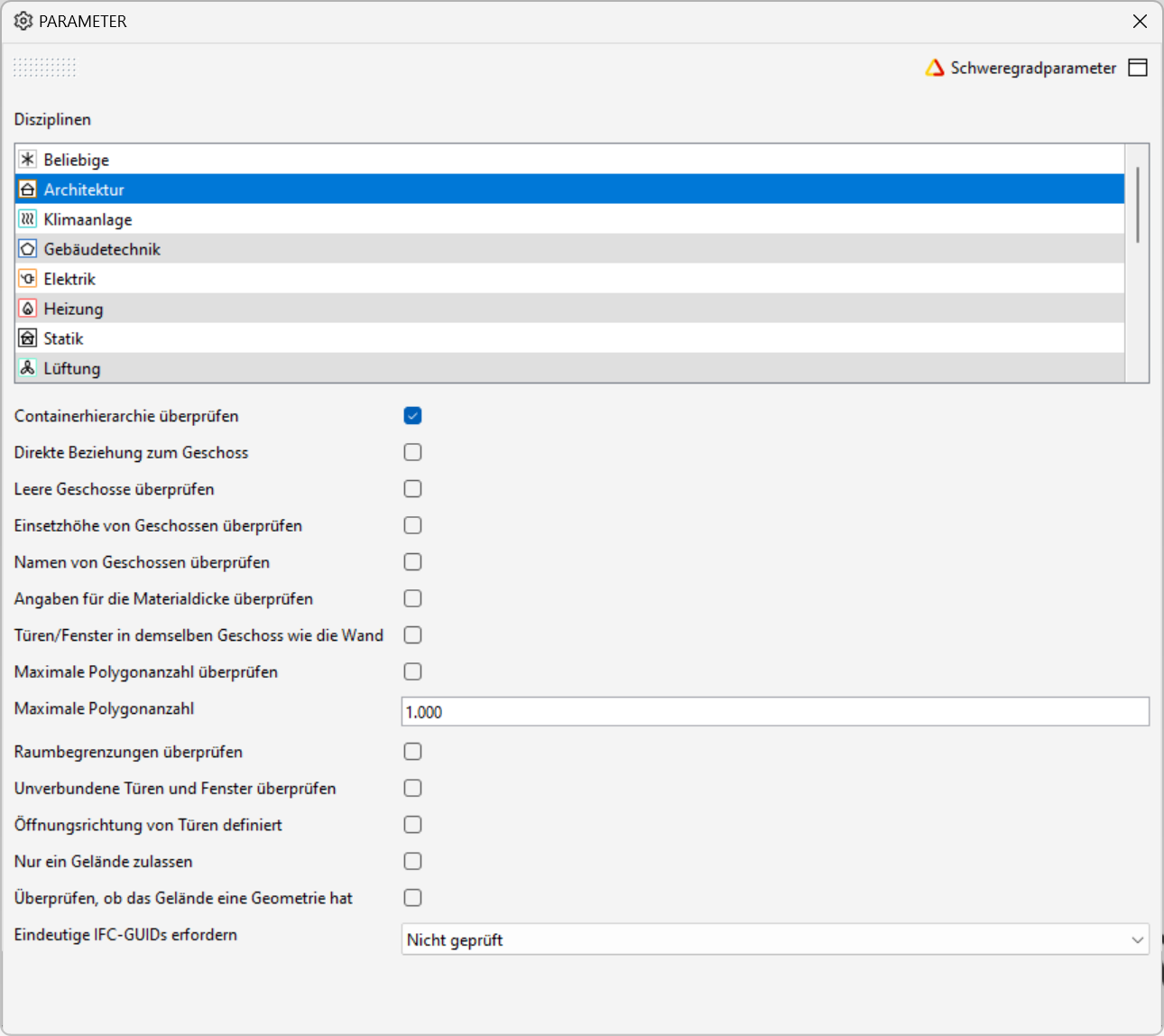

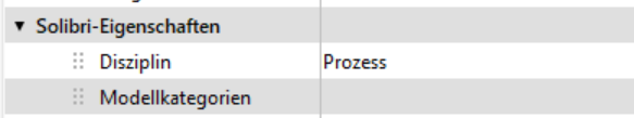

      The rule still detects errors of other disciplines …
      In this case Architecture =/= Process and I get the errors though.
      Edit: Is the checking of the containment hierarchy not intended to work on indiviudal disciplines? It seems like that checkbox is not reflecting the selections above at all.
      JSNJ 1 Reply Last reply
        @JSN said in Floor asignment of components:
