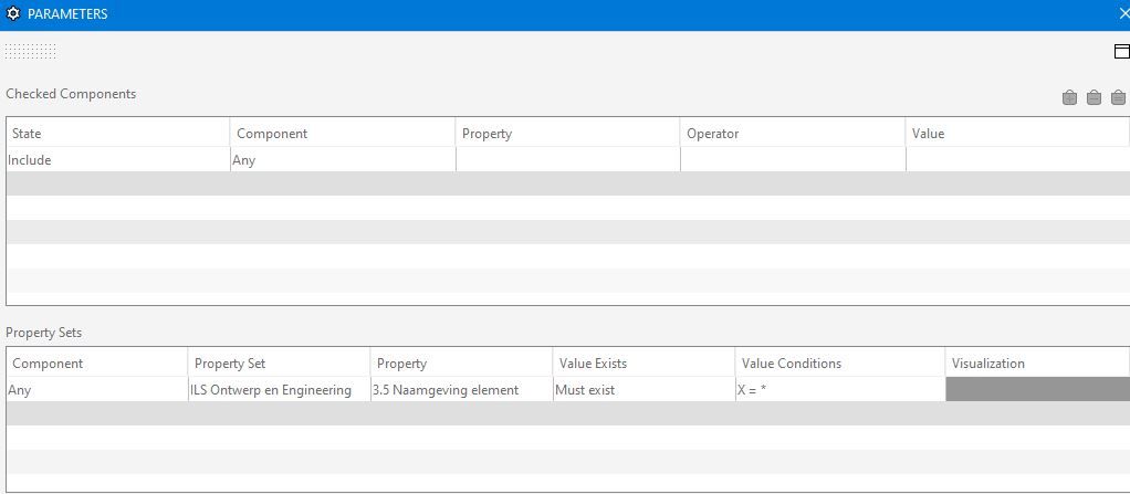

        Hello,
        I use 203/2.4 for checking a parameter.
        This ruleset has the posibility to indicate that the value must exist.
        In the Value Conditions you put a *.
        Then you whil see that the results are giving missing property’s.
        Or the parameter is missing.
