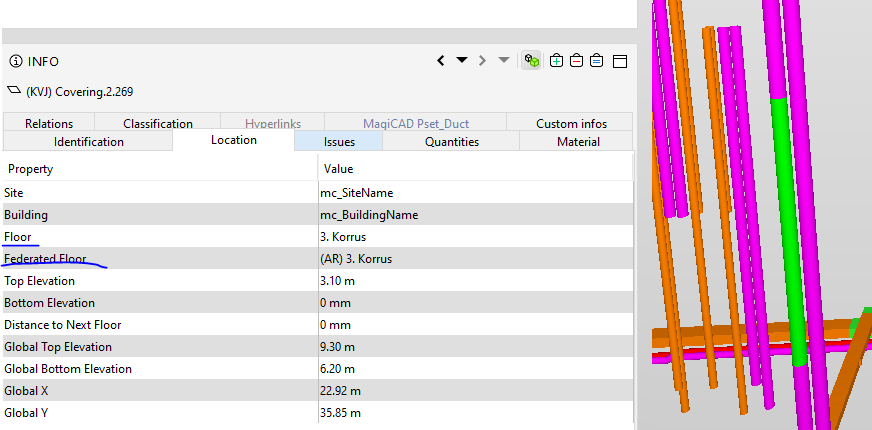

    Is it possible to group rule Intersections in MEP Models results by Floor?

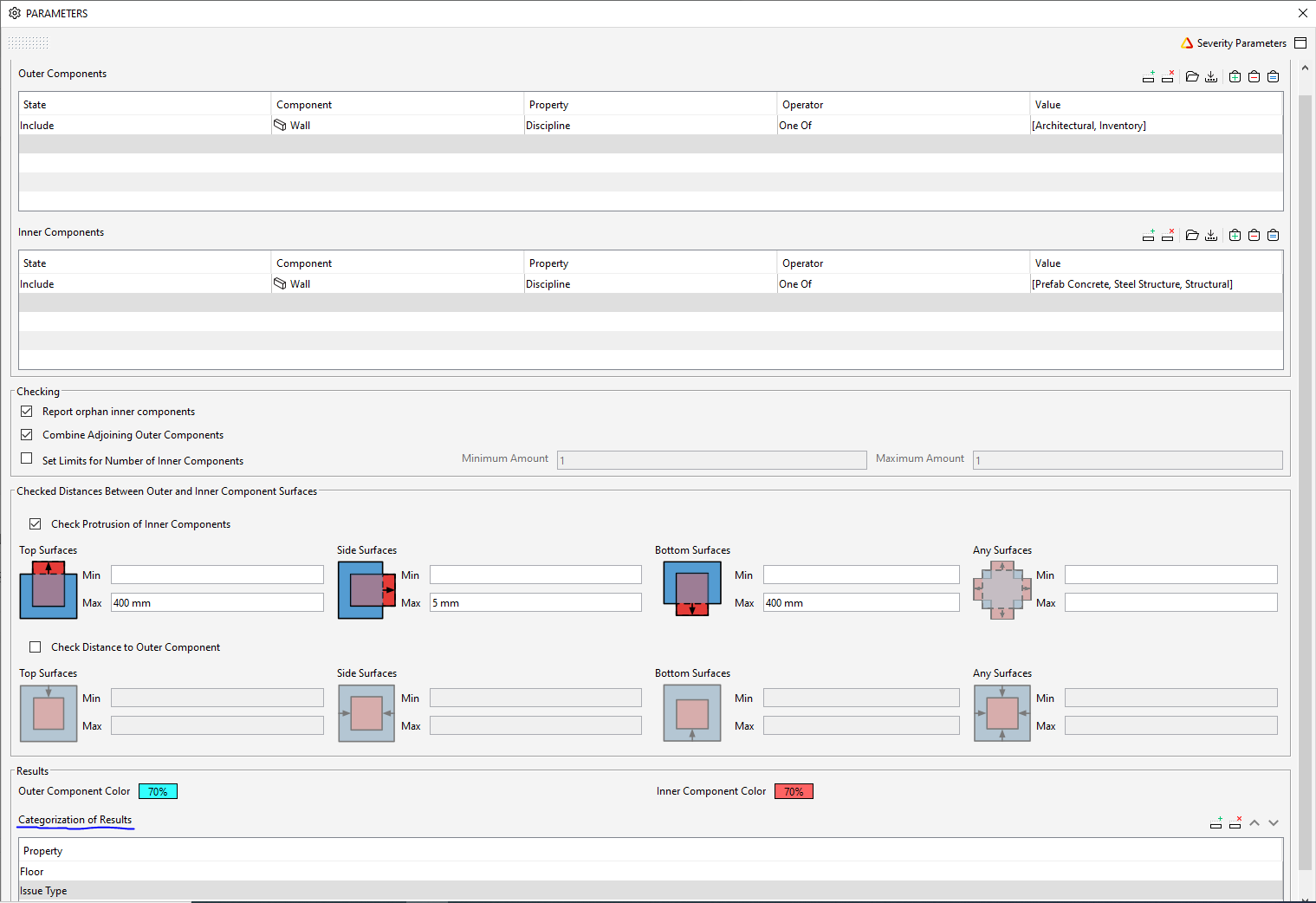

    I am looking something similar that rule Structural Components Fit in Arhitectural Ones in ruleset Structural versus Arhitectural Models does.
      lraimo
      Is there any solution for this? It would be create if rule Intersections in MEP Models would have ability to change Categorication of Results the same way like in rule Structural Components Fit in Arhitectural Ones

        By the way, how are MEP elements properly assigned to a homestory? I mean if you have vertical elements like ducts and pipes going through multiple building storeys. Where do they belong? One of our MEP engineers asked me recently and actually I could not really find a reference for that. Any ideas?

          At the moment I am using different rule for every story (using classification to achieve this) but if I need to change something in the rule it is time consuming to go change every rule by floor.

            Ok, well i agree with you that is painful and the categorization results should be supported by other rules as well and I think there are already some requests here where you can vote for this wish if I remember correctly - If not create a feature request.
            In the meantime you could probably filter you results manually - I hardly use it at it requires manual changes too, but it might help you anyhow.

            But if you have elements that go through multiple building storeys then as far as I know they belong to the storey they were assigned to in the design program.
            Well right, but if there is an MEP Object (which should not be split of course) starting in level -1 and going up till Idk maybe level 2, what homestory should be assigned?
              According BIM requirements in Estonia, such elements must be assigned to the lowest storey
