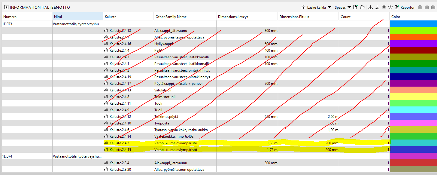

          In my case, there is a lot of different spaces overlapping, such as gross areas etc. I managed to exclude them by modifying the classification.
          I got the spaces listed and their furniture listed below the spaces (the curtain rails are furniture in this model). Now the problem is that in some spaces contain a lot of furniture (like 100 pieces). Is there any way to filter what furniture elements are included (by classification or something like that) since at this point, I’m only interested in the curtain rails (in most spaces there are no curtains or just maybe 1 or 2 elements out of 10 to 100) and this is quite messy with all the elements included?
