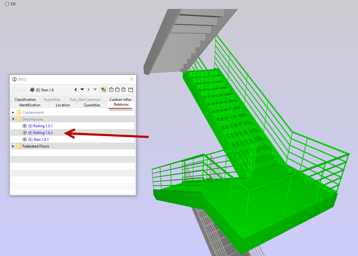

      Can you see this kind of “decomposes” relation between the stairs and railings:
      This is how it is shown in Solibri when the relation is exported into the ifc file. If you see the relation and can explain what the check should do i can help with the rule creation. Do you have an example model to test with?
      If the relation is not in the ifc file i suggest you find out from the authoring tool side how the export should be done,

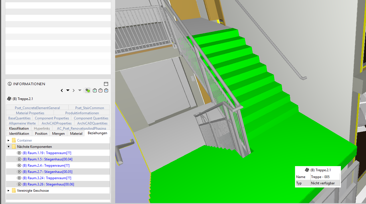

        @Lauri-Luoma
        Yes, the Problem is that there is no relation at all.
        There you can see. The only relation the Stairs have is the Spaces (“Raum” in german) surrounding them.
