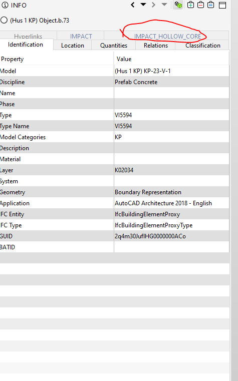

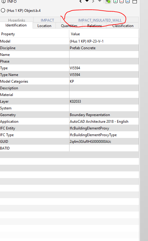

        Object A has the marked property set.
        Object B has another property set
        I would like to Define them trough a Classification only based on the property set name. Se below for example
        Impact_Insulated_wall= Wall
        IMpact_HOllW_CORE= HDF

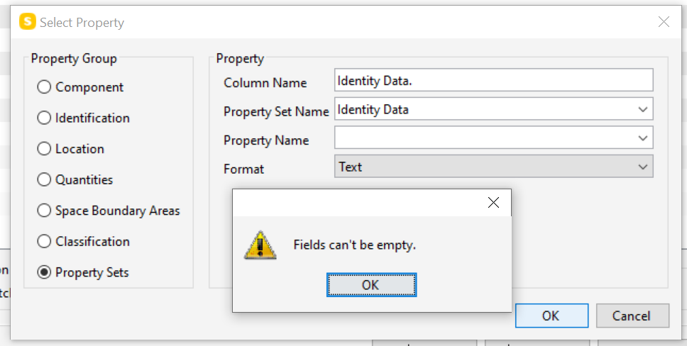

          When selecting a Property set in a classification, the ‘Property Name’ Field can not be empty. So, in your case I would suggest looking for a property that is always in that Property set. From that point, it should be setup like any other classification.

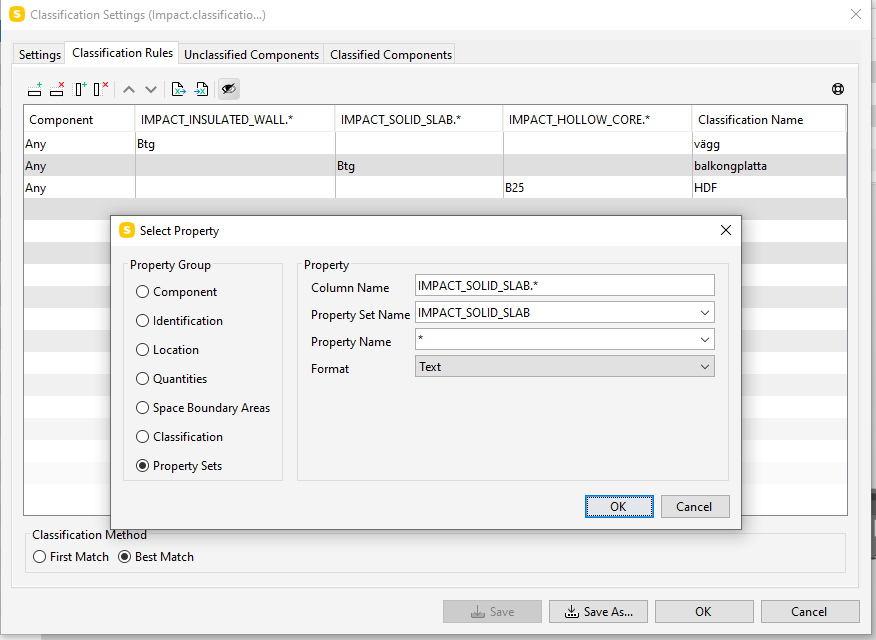

              You can use wildcards (*) in the Poperty Set Name.
              So it is possible to put there for example: IMPACT_*
              Then Solibri looks in both your highlighted Propertysets for the same Property.
              I do this all the time for example for the property FireRating, which is available under many Common Property Sets.
              if you use this
              It wil look through all Propertysets like Pset_WallCommon, Pset_SlabCommon, Pset_WindowCommon etc.
              Hope that answers your question.

                That seem to work. the setting im using for now. Just picked a pramter that showed up in the dotted menu
                • JeroenKoomenJ Offline
                  JeroenKoomen
                  If you want to combine all your columns in one you can use IMPACT_* as value for the Popery Set Name
