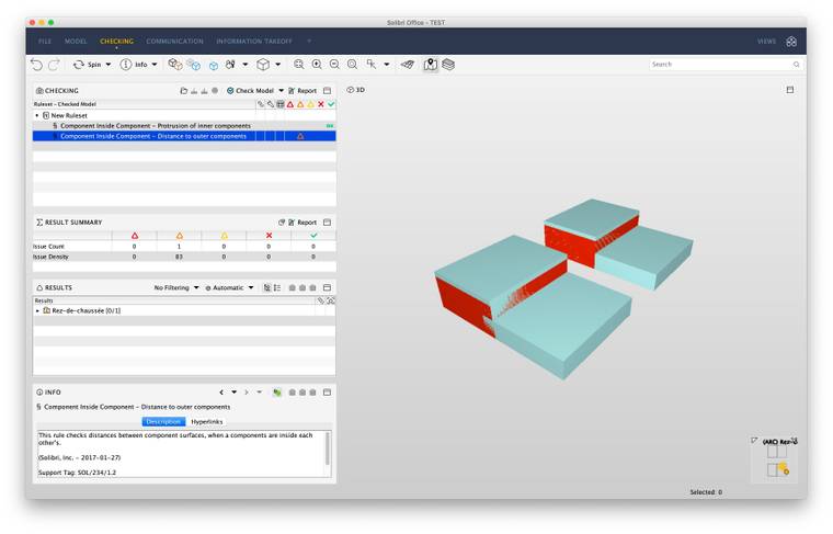

    Hi everyone, I already posted this but it’s been marked as resolved when it wasn’t…
    Here’s the problem with rule 234 :

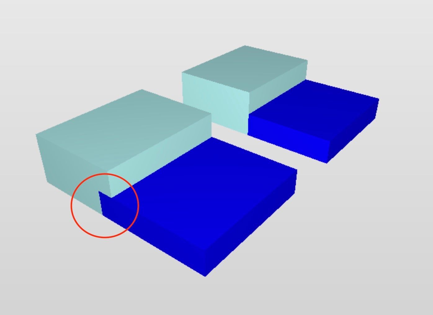

    In the example I have 2 times the same inner element (the red elements) with the top side too far away from the top.
    The outer elements (blue) are combined in the rule. In one case it is simply two slabs that touch each other. In the other one the smaller slab comes into the bigger one and creates a boolean operation (there is no intersection, just a different way of modeling the two volumes).
    As you can see in the SMC file attached, the rule cannot detect the problem in the second case which does not look normal to me. The rule should detect these two problems in the same way because the outer components are joined.
    test.smc
    Let me know it you have any question or information.
