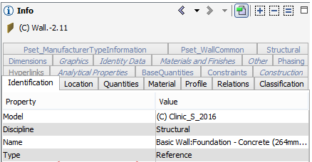

    Wir are developer of a TGA planning tool (CAD). One feature of our tool is to produce a ifc export file (step file format). Up till now we used the fact, that solibri displays within the Type field of the Identification Tab the value of the property psetXCommon:reference (as stated in the document “Overview of New Features of SMC 9.7”)
    For IfcFlowSegment or IfcFlowFitting we used the Pset_DistributionFlowElementCommon:Reference property.
    With Ifc specification 4.x, the Ifc classes have changed. IfcFlowSegment and IfcFlowFitting became IfcPipeSegment and IfcPipeFitting and the previously used Pset_DistributionFlowElementCommonReference is obsolete. In my understanding, the properties needed would be now Pset_PipeSegmentTypeCommon::Reference and Pset_PipeFittingTypeCommon:Reference but Solibri Anywhere does not react on the values of this properties (for me it looks actually like a solibri bug)
    Does anyone has some experience on this topic? Help would be very much appreciated
