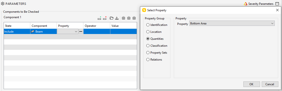

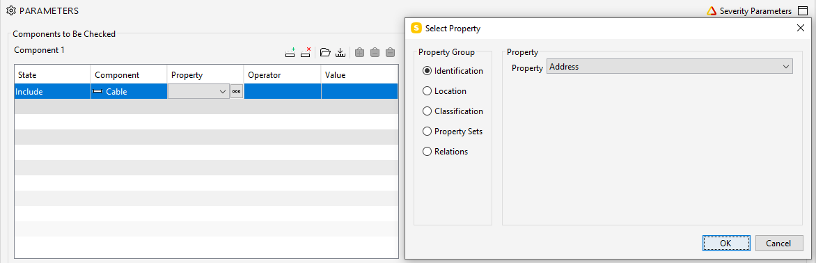

    While making a new ruleset in Solibri update 9.10.8 i discovered that some objects is missing a “property group” called “Quantities”.
    For example, if i select a Cable the property group looks like this:
    But if select a Beam the property group looks like this:
    I have checked directly in the model and both objects have a tab called “Quantities” with information within them.

      Unfortunately Bounding Box Height, Length and Width are missing in Filter and Classification column editor in 9.10.8. The Quantities are missing totally because the Cable is not having other than the bounding box values.
      We will put the bounding box values back there.
