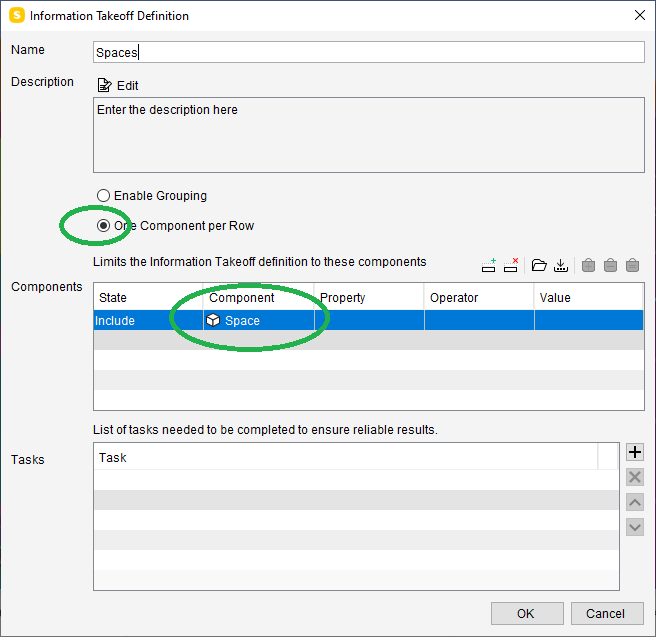

      There is a workaround with ITO and Selection Basket:
      1. Make ITO that lists components by space

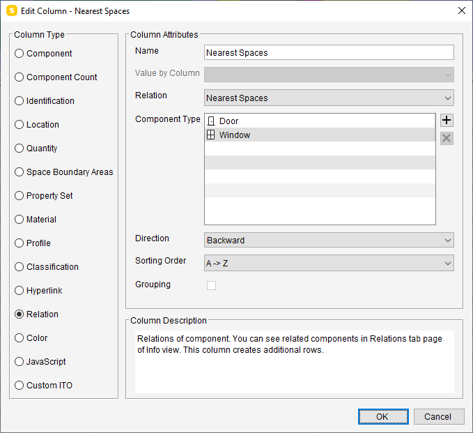

      2. Add a relation column with nearest spaces (direction = false and components that you check clashes)

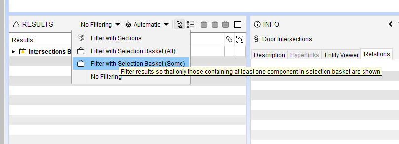

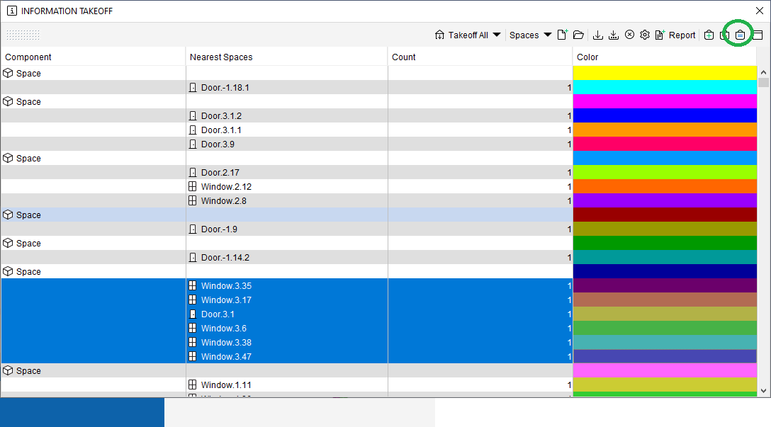

      3. Set manually the components from ITO to selection basket
      4. Filter results by selection basket
