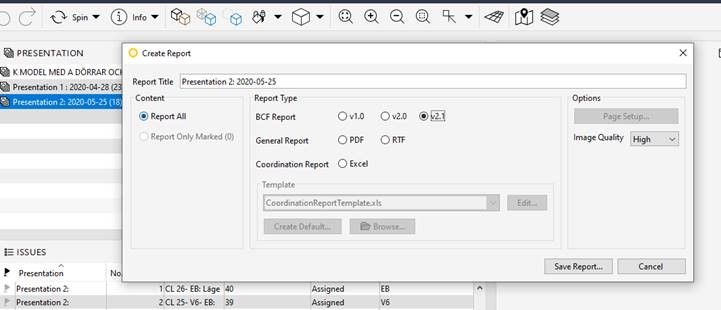

    Is there any one that can help me with solving this issue.
    When I export the presentation it exports nothing, 0kB is exported. Is it that I miss a coordinationReportTemplate? How can I get that template?
    Kind regards
    Maria

      @Maria-Hassani
      Dear Maria,
      It isn’t exporting because of the ’ : ’ character in the Report Title/File Name. When reporting it with BCF, the file can’t be saved with that character. Removing this character will help hopefully.
      When selecting the Excel instead of BCF 2.1, then the templates are used to create an Excel report. Clicking the Excel button, the ‘Browse’ icon lights up, so you’re able to see them in the Windows Explorer and change the template.
      Please separate these two actions. Or exporting an BCF-file or to Excel (and able to adjust the Template if required).
      Hope to get you up and running with this response. Good luck 😉
      • M Offline
        M Offline
        Maria Hassani
        ooh now I understand the problem. It worked, Thank you!! 🙂
