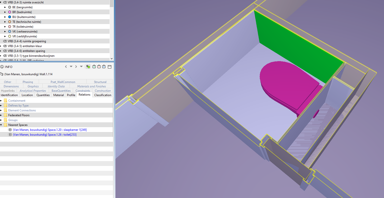

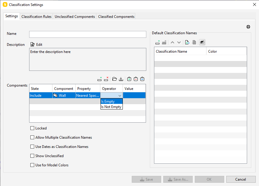

          The wall tiles have a relation with the toilet space. But when i would like make a classification i can’t select a relation to this space.
          Image: Relation with nearest space ‘toilet’.
          Image: In the operator only the option ‘Is Empty’ or ‘Is Not Empty’ is available.

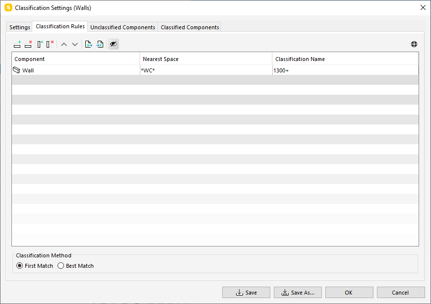

            Try this:

                Great @Matti-Kannala! That’s work fine!
                I was using the Property Group ‘Relations’, that’s the problem… When i’m using the Property Group ‘Location’ > ‘Nearest Space’ i can check the model on the property ‘Top Elevation’ with the correct value. Fixed! 👍
