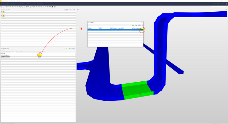

    I just ran into an unexpected problem:

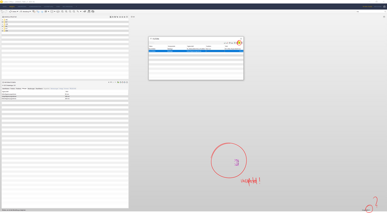

    Although you can use the boundingbox measurements for filtering, the filter condition does not show any result but zero components selected
    fe. “höhe begrenzungsrahmen” (boundingbox height) > 0mm (should obviously show results)
    See below:
    feel free to try on your own.

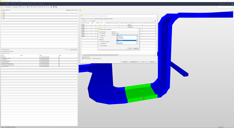

    plus the option for filtering according to bounding box measurements is not even available in classifications:
    please get this working for the next release. filtering for bounding box measurements PLUS in combination with classifications is pretty crucial when working with ifc data in real world scenarios.

      FYI; The problems with bounding box filtering are fixed in the next release. We hope to get it out soon.
