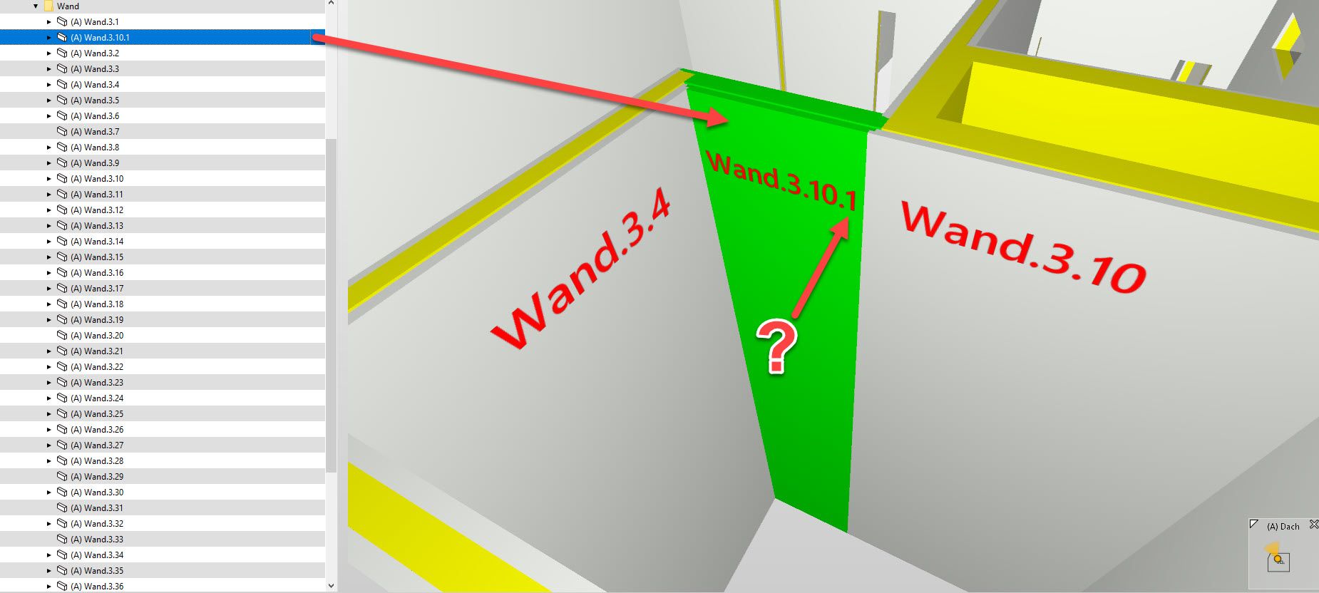

    I have a question regarding element names… In the element name (Wall.2.1), there were always 2 numbers: the first one indicating the floor, and the second one was a counted part within elements on the floor.
    But in my model, there appears the third number in only one of the walls, which should be exactly the same as the other walls. Walls.3.10.1 and Walls.3.4 have exactly the same properties, but one has a 3rd number. Does anyone have the answer to why this happens?

      Hi. I checked this from the codebase and the third number is visible in some cases where the component decomposes.

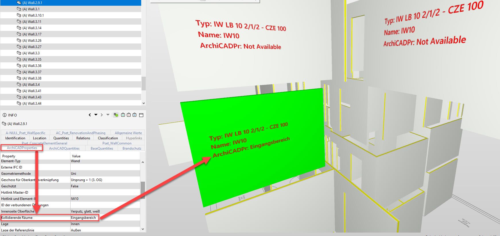

        @lasse-lindqvist I think I found the difference between the spaces with an additional nr. It seems there is a Value in ArchiCADProperties>Kollidierende Räume - where this value comes from has still got to determined, for it is not a clash with space, as I have thought.
