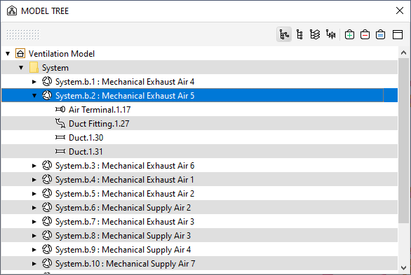

      system
      The system field shows which system the element belongs.
      It is usually available for building service elements like ducts and pipes.
      The system can be e.g. “Outgoing Air”.

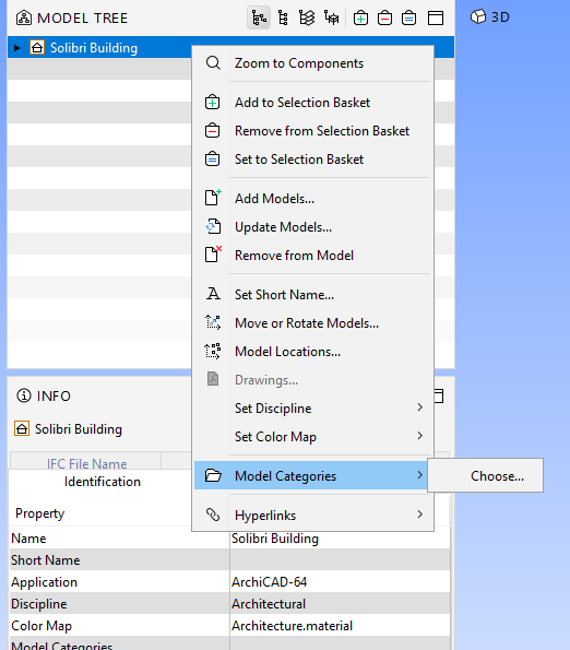

      model categories
      The model categories field shows which model categories the model of element belongs.
      It is filled only when the user have set models to categories.
      They can be edited using the command from popup menu of the model tree.
      The model categories can be e.g. “Building Services”
