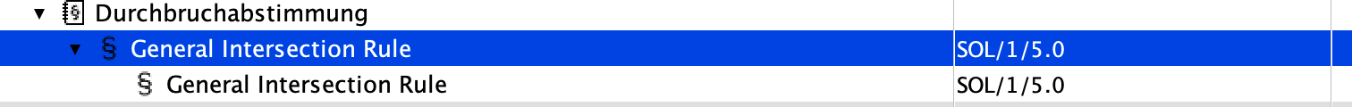

      Here you see the cascaded ruleset:

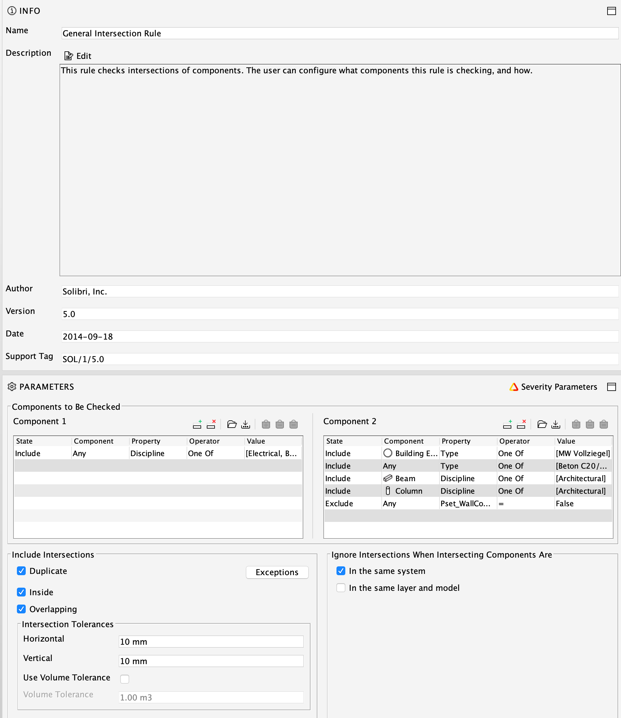

      Here are the settings for the first step. The elements in the component 1 filter are your voids, elements in the component 2 filter your pipes, etc.:

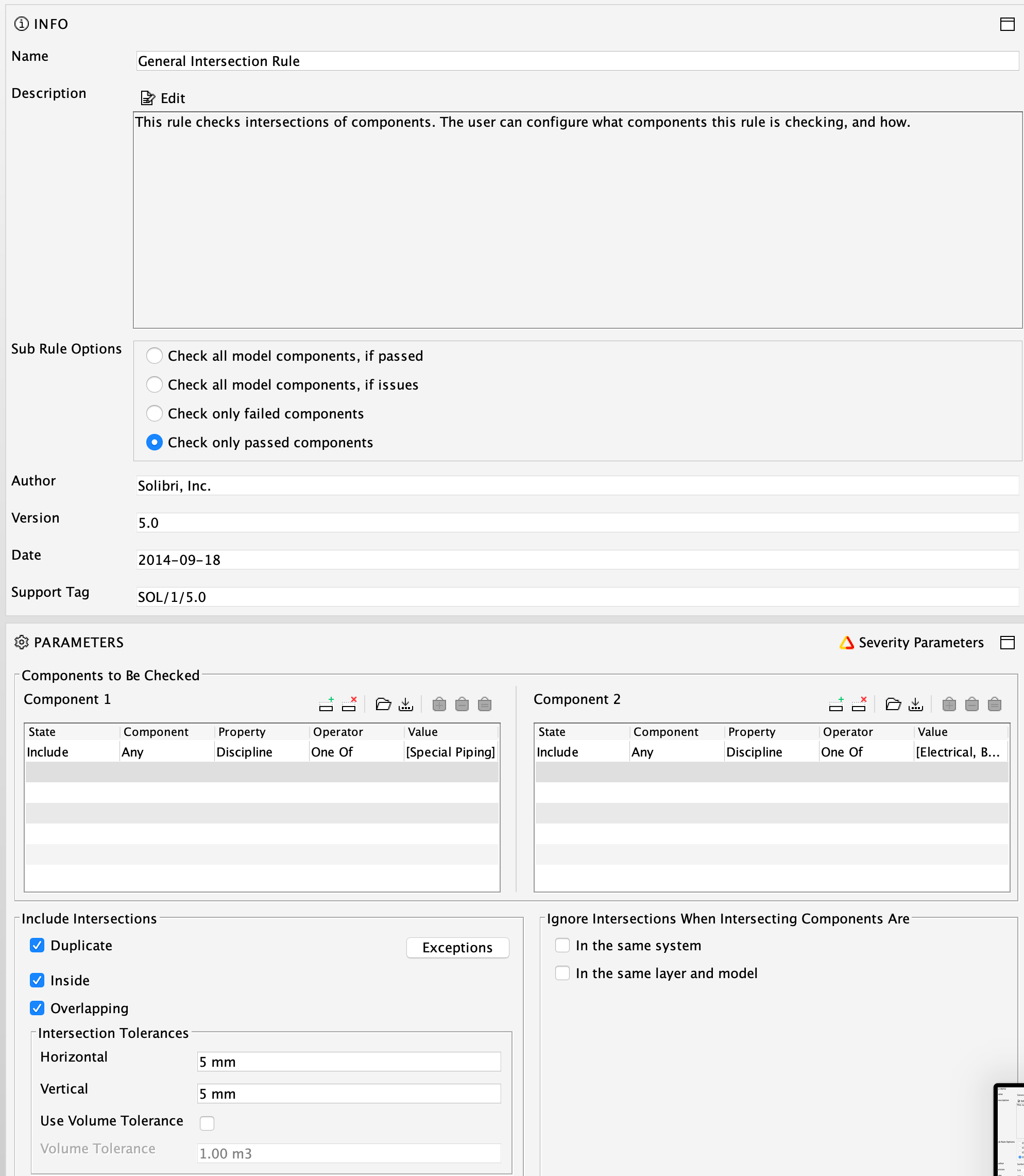

      And the settings for the second step of the cascade. Elements of the component 1 filter are the pipes etc. which passed the first cascade, elements of the component 2 filter the parts of the structural or architectural model you want to check for collisions:

                              You’re welcome. Don’t forget to enable the checkbox “Check only passed components” in the first cascade rule!
