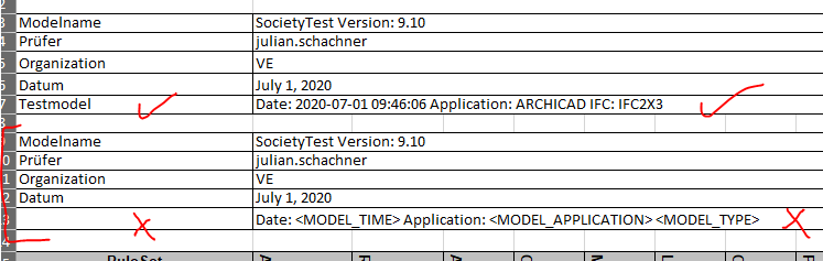

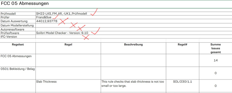

    Hey there.

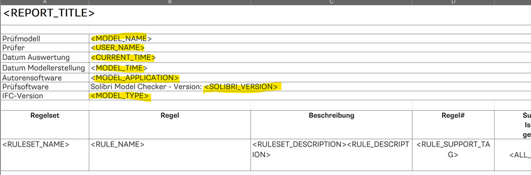

    I tried to make a excel-report-template for the result summary by deconstructing a default-solibri-template. i just regrouped the auto-texting from a built-in solibri-template and put them into a different order. unfortunately the export of some of the auto-texts does not seem to work any more but without (at least for my understanding) any logical / particular reason…some of them work / are exported, some don’t / are not…if i change the order others don’t work…
    hope someone can help.
    thx in advance
    Thomas
      I can confirm this is a bit tricky. I remeber that I was having troubles with it when I tried to change it. I just made a quick check and it seems like that there is something either not properly working or it is just not user friendly at all.
      Made a quick test and just copied the auto-text rows with a rather similiar outcome.
      After that test I had the idea that maybe it’s just not possible to assign auto-text multiple times and tried to shift elements. Then I got a similiar result like you did. So, what are we missing here?
