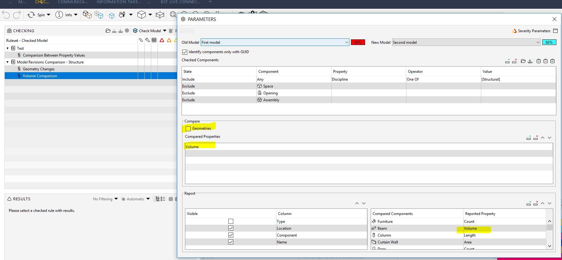

Hi Niek,
You can use the Comparison Rule 231 to check differences between just the volumes of elements, you can then untick the GUID to check elements with similar Type, Location and Geometry, I’m not completely sure on how this works but worth a shot,
Un tick “geometries” and add “volume” to the compared property. This will then only report on volume differences of elements.
