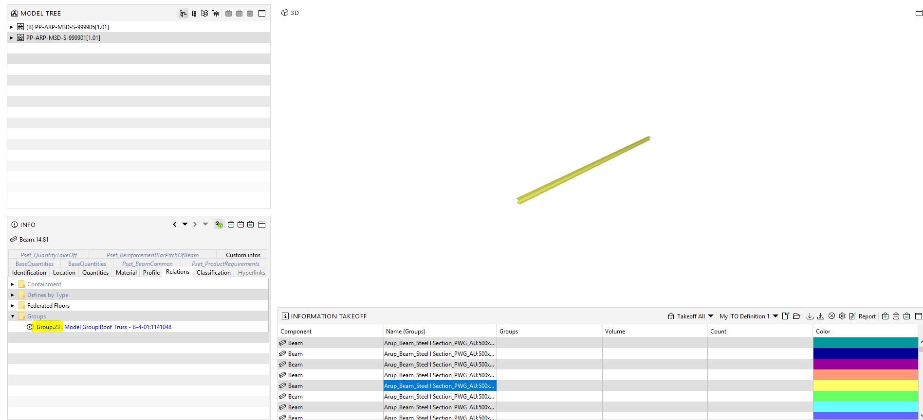

    Is it possible in an ITO to group by a relation group? For example group by "Truss Group 23"Capture.JPG

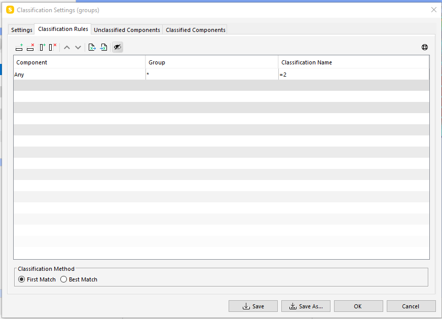

        Change the layout and move the column to the left.
          Sebastiaan
          first create a classification for the groups, returning the group names.
          Then create a ITO based on the classification names
