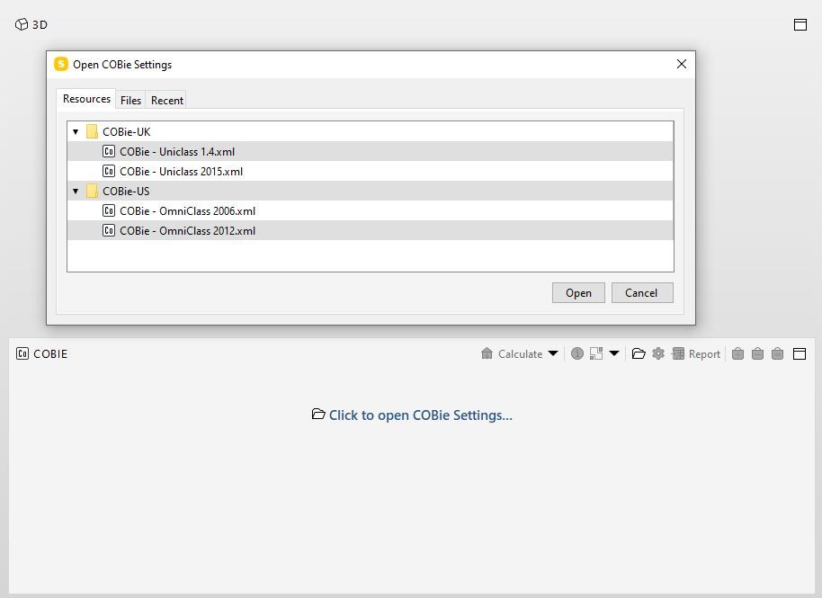

        Hello everyone,
        I join the request already made by @RobA
        I was wondering if it is possible to modify one of COBie xml files, with the aim of adding new sheets or editing existing ones.
        If this is possible, where can I find this xml file?
        Thank you very much for your suggestions!
          wrote on last edited by Matti

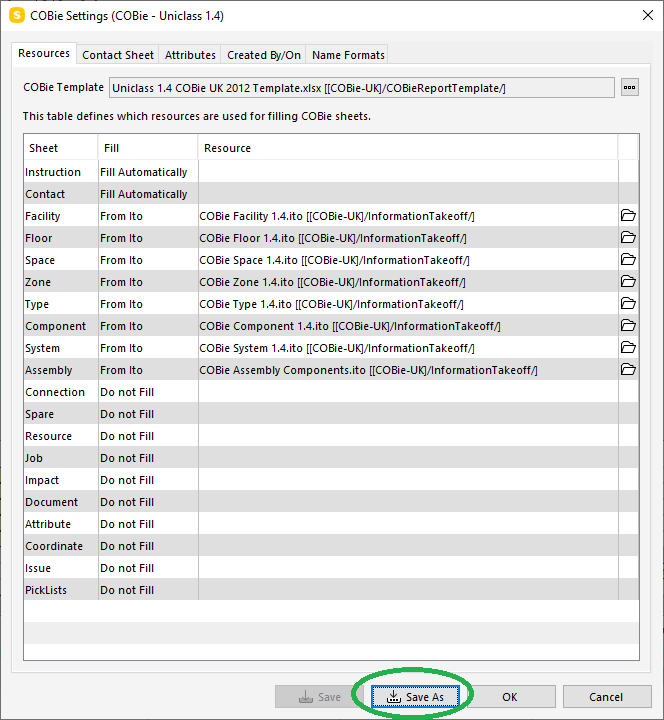

          The XML file is easy to find by saving it with name:
          1. Save template to a file
          2. Edit templete in text editor
          I will now check what is possible in the current version.
            @paola-bronzo said in Edit COBie Template:
            • Unfortunately it is not possible add new sheets.
            • Only the sheets names visible in the XML can be used. Others are discarded.
            • Columns of existing sheets can be edited and filled from your custom Information Takeoffs.
            • Please note that the Information Takeoff column name and COBie template Excel file column names must match.
