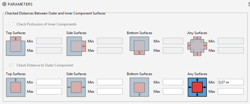

      I am not sure what exactly you want to achieve but did you have a closer look on rule #234?
      The rule can check if e.g. your reinforcement is located in a wall correctly, but you can also utilize this rule a lot for other purposes like distances between objects and I use it a lot. It might not be the perfect solution for you but you could try … or #222 for the Distance Calculation … or probably both?

          Bounding Box in Classifications might not be possible (btw, can any Solibrian tell us why?) but what about bottom area? I guess the vertical bars have just a very small one and this might help you to distinguish them via classification settings if there is no property or special naming which could help you here.
          Another possibility might be to use nested rules as there is indeed the possibility to check for Bounding Box Values. So then I would suggest you to go for two hierarchies, one for the Vertical bars and another one for the Horizontal ones. Both of them would contain the same subrule which is either #222 or #234 and only checks the passed components of the main rule.
          Although I do not really understand why you have to know first if it is vertical or horizontal for checking as you can also define in the rules which dimension (x/y or z) the min and max spacing should be. If it just for classification ok, but actually it should not limitate you can filter them out in ITOs as well using the same method - there you can tick the bounding box values as we know.
