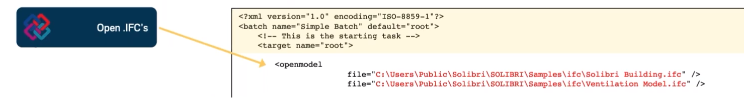

    I know it is possible to load a specific IFC on startup with Autorun.

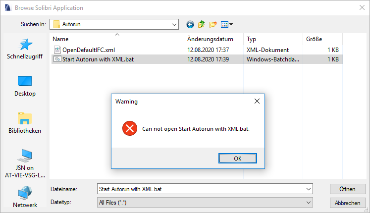

    My question now is how this could be achieved when you open e.g. Solibri Live from Archicad. So that not only my role settings are loaded but also a specific IFC, that is always needed, is automatically added to the model?
    The Arcicad Addon does not allow me to select a batch file as Solibri Application, but is ther a fast workaround like adding the xml path information from the batch file to the shortcut or combine it in an .exe or so?

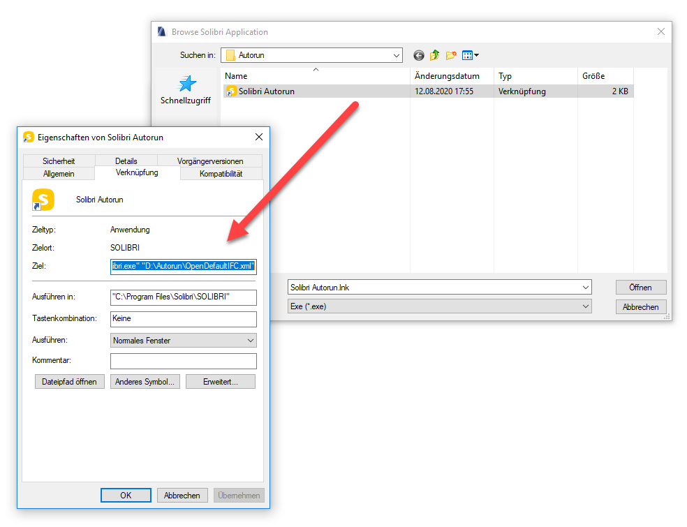

    EDIT: For clarification, I can indeed create a shortcut with the same functionality like the batch file.
    However, when I select it, the xml suffix is not taken in consideration as it automatically jumps to the executable.
    … and while this would work if people open Solibri manually, it will be ignored when opened within AC … and this is actually necessary to make the Live Link working.
