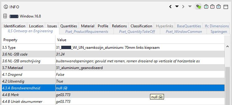

    I try to write all values ​​of the fire resistance in a Solibri Classification.
    However, I cannot write the fire resistance “Null (0)” to that classification.
    Anyone can help me with this? See image:
    Thanx in advance,
    Loek

      Hello @lvsteijn ,
      please note that properties shown in italics, in brackets strike-through have a specific meaning in Solibri. You can find the whole explanation e.g. here: https://www.solibri.com/learn/overview-of-new-features-of-smc-9-7
      From there you can take:
      Properties defined in type instances are shown in italics (properties defined in component instance level are shown in normal font). This is a helpful tool, as you will now know whether a property is defined by the Type of the component, or if it is unique to the individual component. If a value defined in the type instance differs from a value defined in the component instance, it is shown as a ‘strike through.’
      So in your case, the actual value your classification would apply to is ‘null’ - the strikethrough part can be omitted. Could you please check?
      Cheers
      Cornelius

        @cpreidel Thanx for your Reply.
        In Revit there is only a Type Parameter, which has a value “0”
